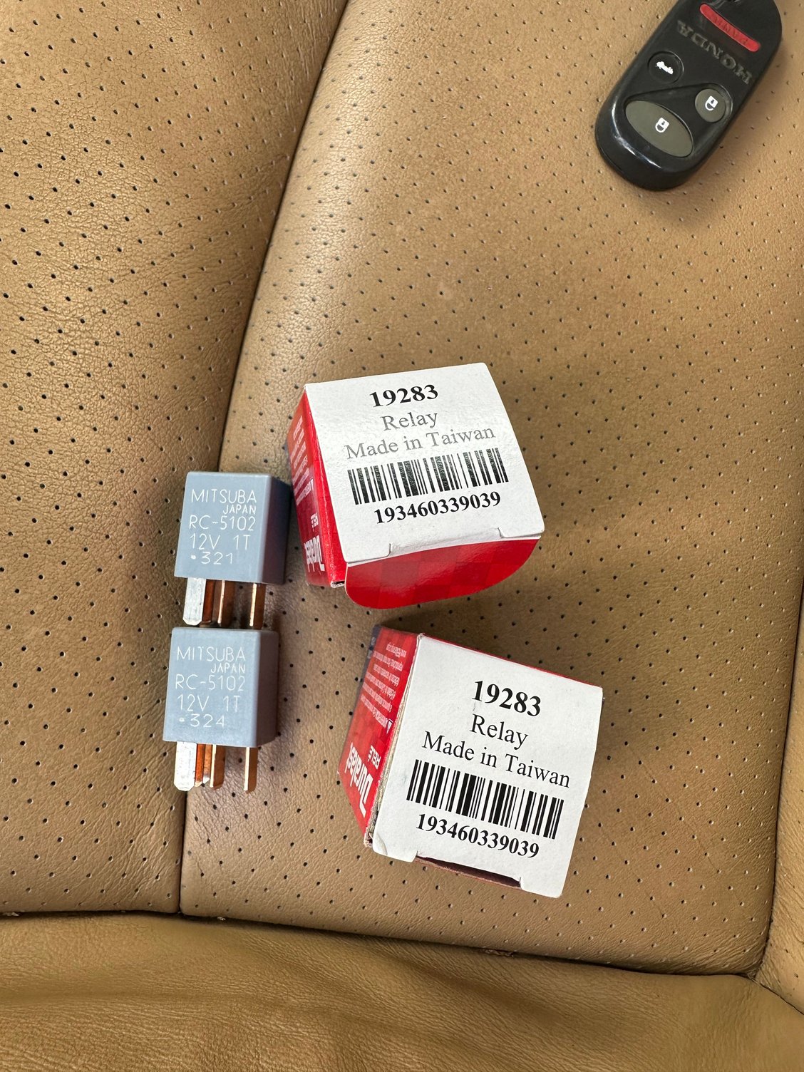

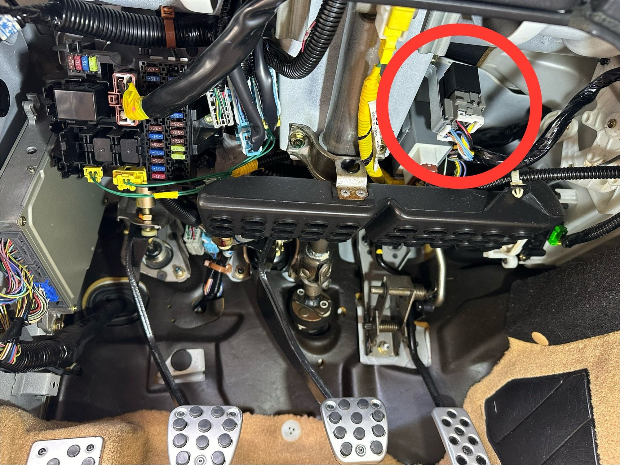

Since 99% of the people with this problem never followed up on their own thread, I will share the fix here to hopefully help a homie in the future!
It was the two twin relays above the white plug on the righter section of the driver foot well area. I’ll try to upload photos. Someone from the fb group had this exact issue and ended up FaceTiming me and he told me exactly where it was. Came in clutch!! That’s all folks!

Originally Posted by Chuck S
Source for the relays?
-- Chuck
Hey Chuck
I got them at my local AutoZone for $16.99 each. Everywhere else had to order them or couldn’t order them. Pretty basic relay you can order online also.
The ones I bought you can see in photos were Duralast part # 19283
