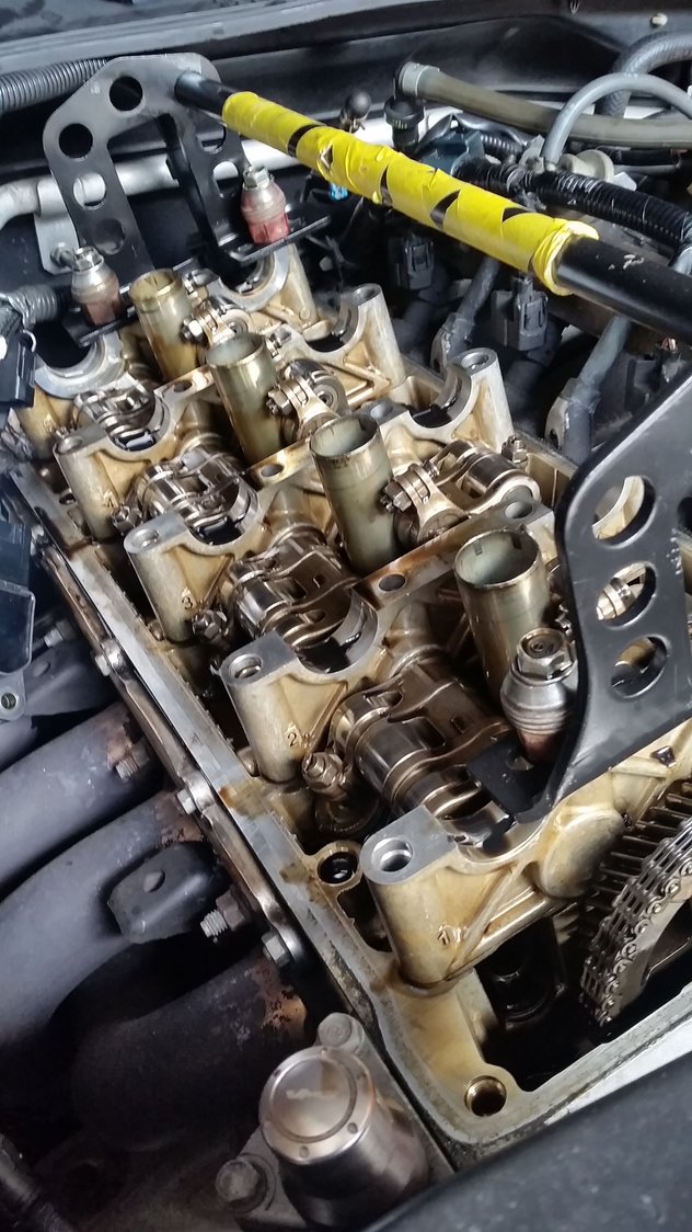

Ok, ripped it back apart, and this time I noticed something that worried me. Here's a pic. It's on the very end, past the #5 cam cap, it doesn't really look new... is this common/normal? The cams seem fine. No wear. (I know the oil is dark I'm changing it that's what strated this whole project)
