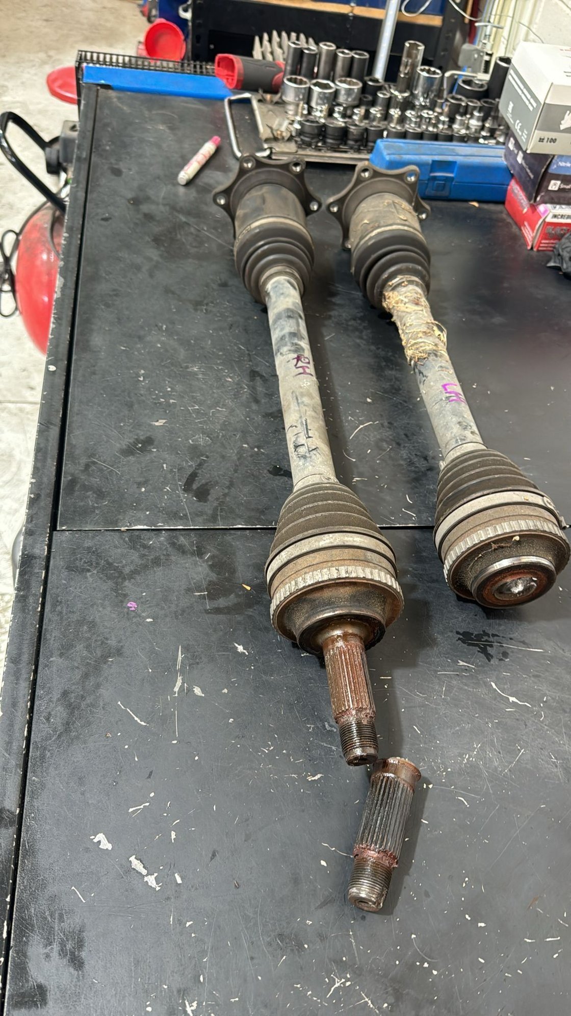

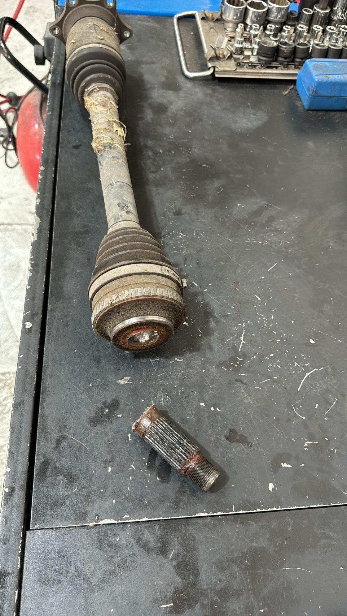

Final update
Changed out for reconditioned oem ones and damnnnn the car drives like a dream now!
So torquey like I’m driving when the car when it’s ice cold outside. Shifts are now rock solid, car feels ultra smooth
I think I’ve been driving my s2k on a broken axleshaft for the last 7 years cause it’s somehow like a new car now
Not sure if placebo from driving a Tesla for the past 2 weeks however
Your new one looks longer than the old one.
You did purchase one for the correct side? The S2000 has different axle lengths from left to right.
Your tech should be mindful of how the new axle spindle nut is torqued. Not just how MUCH torque, but the fastening proedure as a whole.
You need enough tension in the joint to hold the bearing from shifting and failing. But not so much as to yield the axle stub.
Honda has a 220LB-FT torque process. I would use that for a street S2000.
