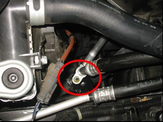

Here's a photo of the connector I undid by mistake. I just started the car and the A/C doesn't work - so I'm guessing I bled the A/C system. Will this be hard to get repressurized?

Yep Kath, that's an A/C hose. Take it to a shop and have them purge and recharge the system and all should be good.
