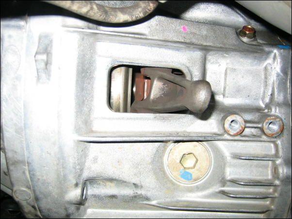

Remove your slave cylinder. It's only two bolts. The fork will pull out very easily.

Pull out the release fork (A) from the release fork hanger. Wedge a shop towel (B) between the opening in the clutch housing and the release fork to hold the release fork in place.
Just pull it off the bearing and let it set in the trans.

Remove the slave cylinder, and pull out on the release fork until it pops free of its internal bracket.

yes its the release fork I guarantee it lol

Yep, a lot of people forget to pull it out......but most of all, don't forget to pull it back in after you done.....you dont want to find yourself having everything assembled just to dissasemble it abain to put the fork back in!
In a matter of fact I saw a post were the hole was cut out just so the guy can insert the fork without taking the tranny out again. )
