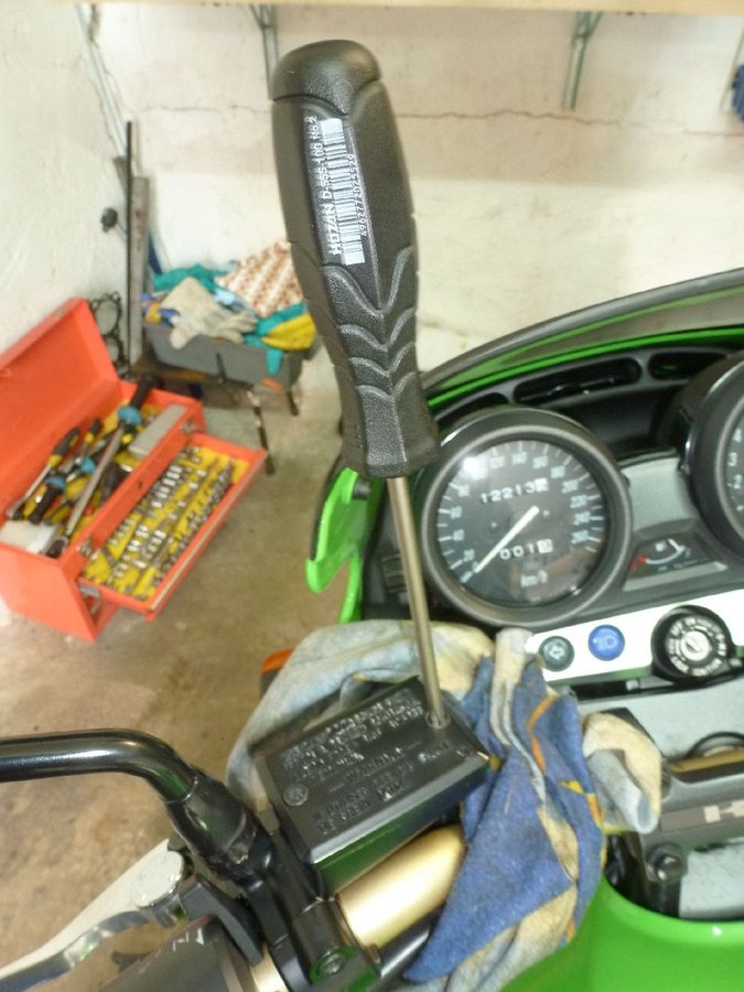

There are also HOZAN JIS screw drivers available, wich are also great. Not as good as the Vessel, but 90%. I own both, the Vessel and the Hozan.
You could recognise JIS screws mostly by a tiny round punch mark. The great thing about JIS screwdrivers is that they dont cam out. You just twist the screw open, like a hex bolt. There is no need to push the srewdriver towards the screw.
Simply great.
Explanation: https://vesseltools.com/handtools/sc...rs/what-is-jis
Picture: HOZAN screwdriver stick into the screw of the brake fluid reservoir of my Kawasaki. No tricks, no Magnets, it´s just the precise, lightly clamping fit wich holds the screwdriver upright.
