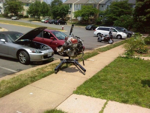

Here's some inspiration for ya:
This was my first time swapping an engine in any car. After reading the factory manual for an entire week and literally memorizing it, it was not that hard, just lots of work. Feel free to PM me if ya need more details.
