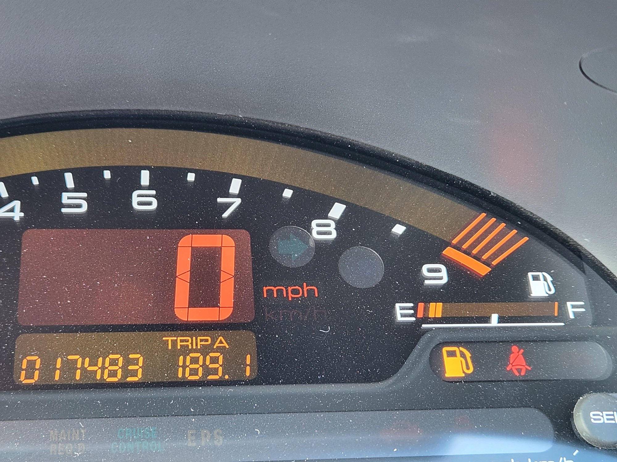

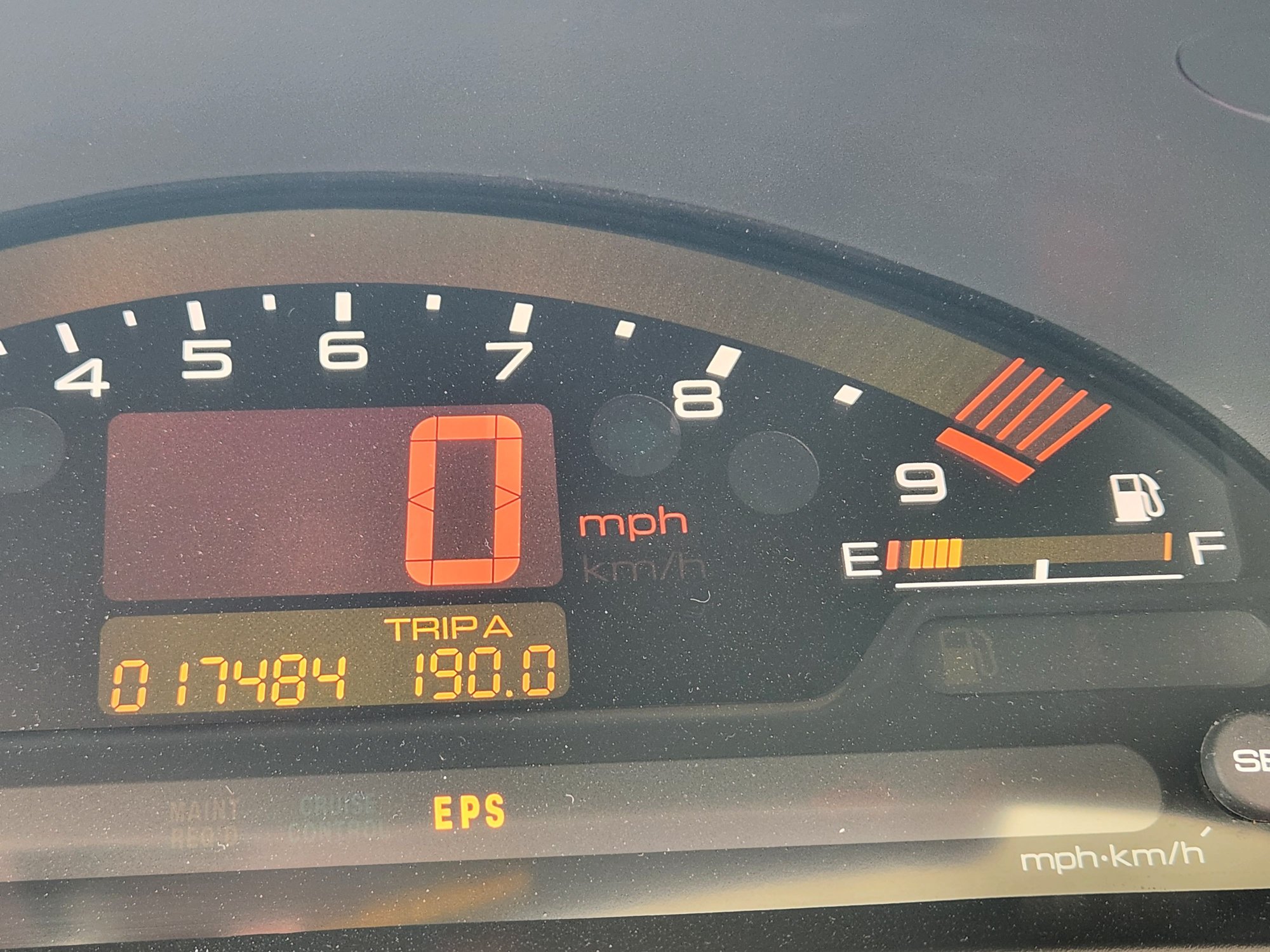

I got the car down to 1 bar, then the fuel light came on. When I parked on a slope it went back up to 2 bars but the light stayed on.
When I got to the gas station, idk y, but I turned the car back on and it went up to 4 bars. I doubt I would trust that.

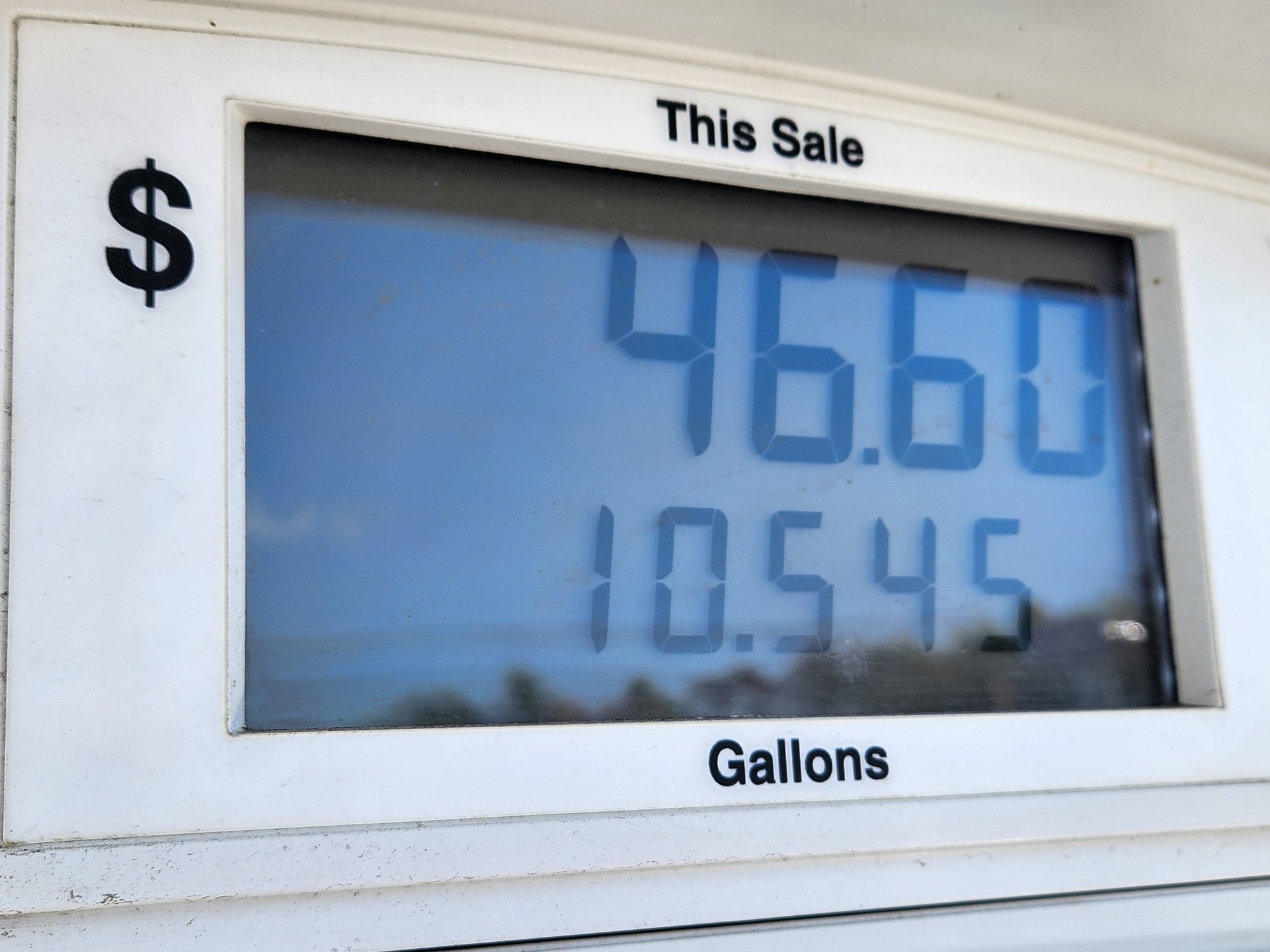

It drank 10.54 gallons. Fuely says I got 18mpgs on the last tank of gas. Shell 93. Probably 90% city driving and a lot of VTEC
Probably a new car I just don't know all the quarks and features of.

Threshold for light to go on is not same to make it go off. This is so you don't have light toggling on off when you're low, and go up down hills, etc.
When last bar disappears, you have about 2 gallons left. Likewise, when you fill up, about 2 gallons need to be used before first bar disappears from full. So that exactly middle of gauge is exactly half tank.
Since you're probably not staring at gauge, can't usually be sure when last bar disappeared, to know for sure how much left. Generally bad idea to run low, as fuel is also coolant for fuel pump. So running low takes life off pump as it overheats. Pain to change.

Yeah... with a 13.2 gallon tank... and the car drank 10.545 gallons... I should have 2.655 left to drive in circles around the gas station for 48.055 more miles until my fuel pump burns out.
All this is to say even the way I'm driving the full tank should have pushed me a total 238miles of mostly city, mostly a lot of VTEC driving.
Car seems fine.
