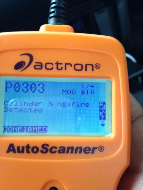

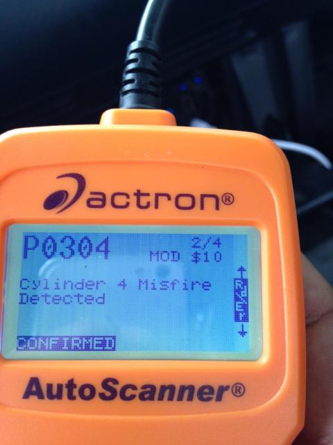

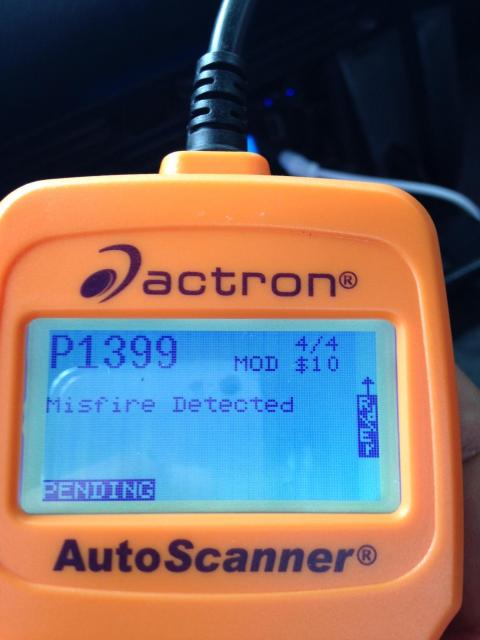

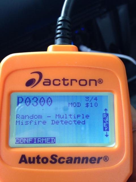

So I ended up buying an engine code reader. The codes that the reader pulled up was p0300, 303, 304, and 1399. So I ended up checking the spark plugs on cylinder 3 and 4. I can tell they didn't get any sparks so i'm guessing it might be from a blown fuse or something wrong with the ground. I'm gonna take my car to the shop tomorrow to get a much need valve adjustment done but I hope all is resolved by tomorrow.

I figured out my problem it was a bent valve. I had a feeling oh well I guess a new head will do.
