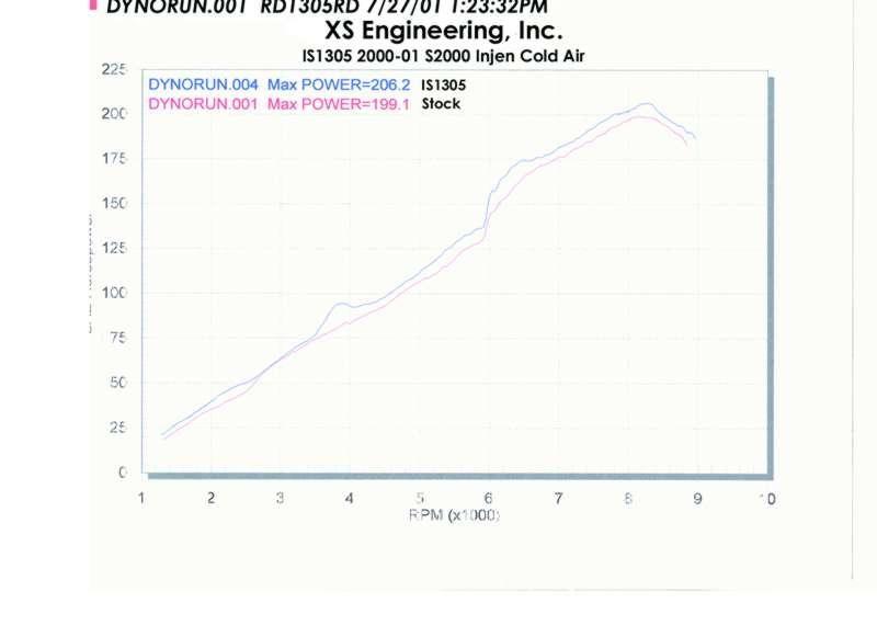

I'm willing to bet that those bumps in your dyno curve are not the result of the ECU, but your Injen CAI. Both the Injen and AEM CAIs have those signature bumps, which are the result of their tuned pipe lengths. FWIW your dyno curves, in relation to stock, look exactly like what I've seen on CAI-equipped but otherwise stock cars.

Wow! What jzr wrote is absolutely correct. I just got this from the Injen web site and there is the bump right where mine is. So, it's not the ECU at all but the intake. So the ECU is doing even less than I thought it was. Amazing.

Make sure your car is relatively in the same state of tune for each dyno session. Iow, things like plugs not getting too worn, valve clearances within specifications, air filter not dirty for one of the runs, etc...

I'm sorry you didnt make the numbers you wanted. I would suggest taking the car back to stock configuration and then make dyno pulls with each mod by itself. It's expensive, but the only way to determine the true culprit. The intake can be changed out quickly and the header can be done quickly too. ECU of course is no problem at all.
I think you should run your stock box with a good filter. I've tried the AEM, Injen, and the RM, and the stock box with a good filter yields the smoothest powerband. But then again, that's on my car. I know other people have had great luck with their intakes. My car just seems to hate them with the stock ECU.

This was made with HKS exhaust, DC Header, STOCK intake, and AEM PEMS. I think you paid about the same for your Mugen ECU that I paid for my EMS. Also, my baseline run was only 193. You made about 10 more rwhp than me!
