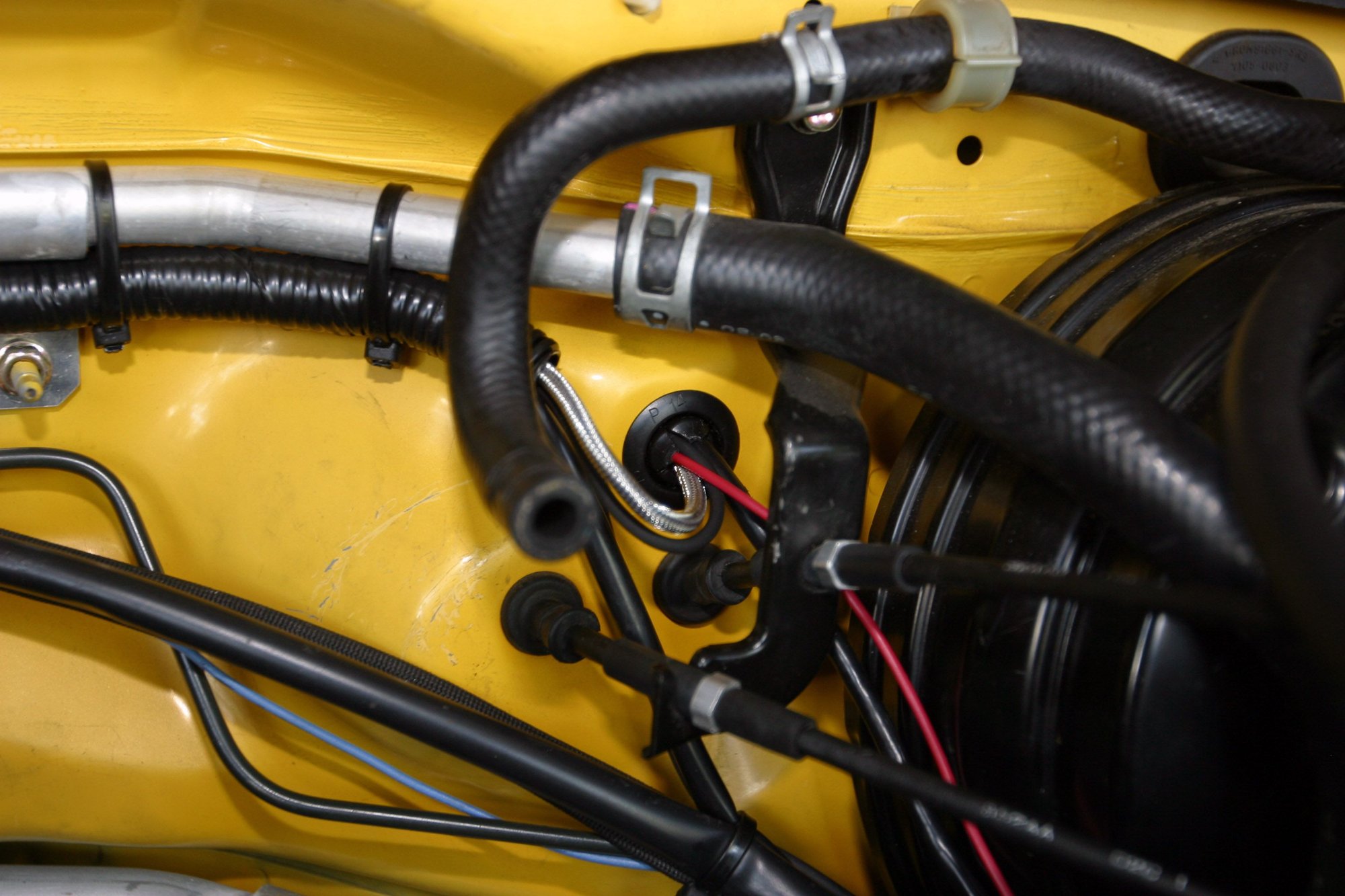

There two grommets that I have used to route wires. Here is a picture of the easiest to get at. Just cut an x in it with a razor blade and push the wire through.
