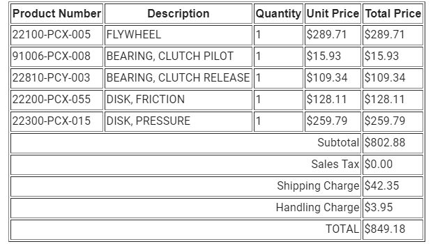

I bought my clutch from them when I replaced it a few years ago. The Pressure and Friction disks cost about $400 total. Throwout bearing was $110.
Old Aug 22, 2019 | 09:00 AM
The PP from majestic is like $400.
Disk is around $185.
Release and pilot bearing around $200
Guide is around $32
Its a hefty bill, that's for sure.
I've been re-using PP's now. I just finished an install with a used PP on one of my S2000's.
If I wasn't doing the work myself (I work for chicken wings and white claws)...I would be cautious with re-using anything. Labour is expensive, it seems. Apparently, this clutch job is seen as "difficult".

Wow, must have gone up on the prices a bit. I quoted directly from my receipt email from Majestic in 2016
I see now the pp is about $377 as you say so I guess I am glad mine failed when it did! lol

Like B said, my mechanic said this is a "difficult" clutch job w/ an "expensive clutch". I ordered the Clutch Masters w/ Nacho bearings from a sponsor on here, I was just curious when I found this thread.
OEM I couldn't find under $800, next would've been going with moddiction's kit.
It seems you dug up cheaper than I was able to find though, thanks for posting what you did.

The receipt posted above was from 2016, bruv. Prices have risen since.
~$800 seems right for a factory clutch.
