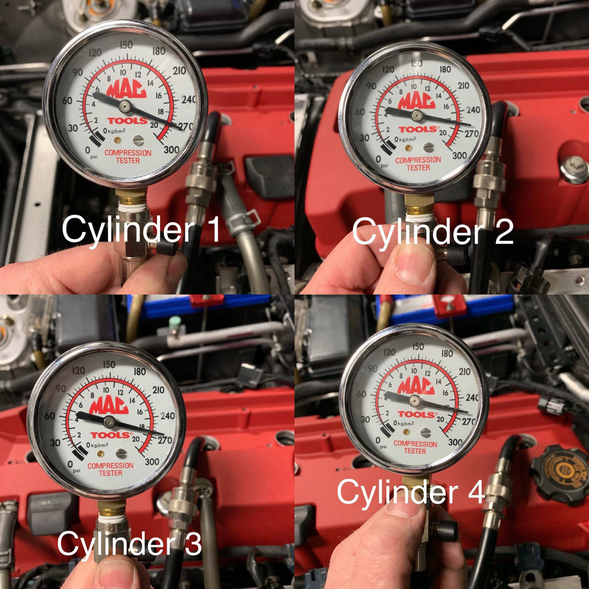

Well, very good news to report here. I have 200 miles on the rebuilt head and all is well so far. Just did a compression test, and all cylinders are at or above 260psi! Funny thing is now cylinder #1 has the highest compression where before it was by far the lowest. This really makes me wonder how many people have junked and/or rebuilt their bottom end and cylinder head due to bad compression numbers.

i doubt people would junk or rebuild bottom end due to low compression, without first figuring out what is causing the low compression, just like you did.
