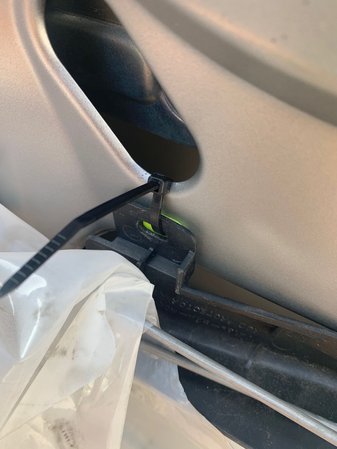

Just purchased my '01 S and it's had a rattle in the passenger side door when opening and closing...was driving me crazy. Took off the interior door trim and discovered that the black plastic guide for the locking mechanism was loose. Zip tied it back on and the rattle is gone!
