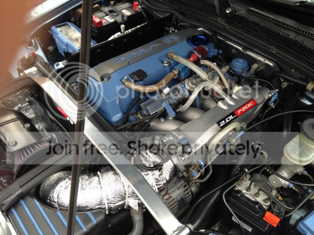

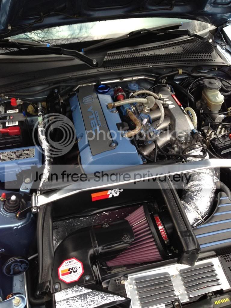

Here's what I did with my PCV and breather:
Zero consumption afterward. Very little drainage in the filter and through the hose also... The reason I ran the hose from the PCV filter line is to vent vapors to the rear with the exhaust.

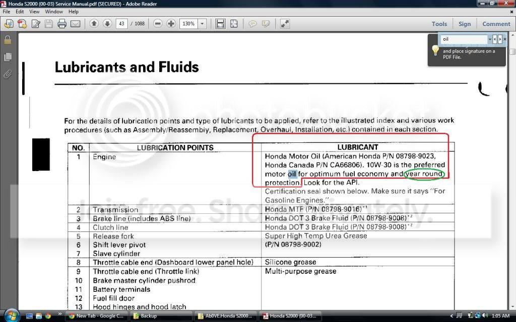

  #29
AP1Driver's Avatar
Joined: Jun 2011
Posts: 1,003
Directly from the FSM. Nothing mentioned anywhere about any other weights of oil.
Take the board's and Honda's advice.
Old Mar 29, 2013 | 09:27 PM
  #30
GravyRobber's Avatar
Joined: Jan 2012
Posts: 538
From: Tennessee
Ah cool thanks for posting...was just looking for that online. Maybe I'll go back to the 10w30 after all.
Was just talking to a friend the other day about this, and he suggested the 15w-40. As a certified mechanic, and owner of 3 S2000's, I decided to take his advice. Might go get some 10W-30 to put back in though :-/
