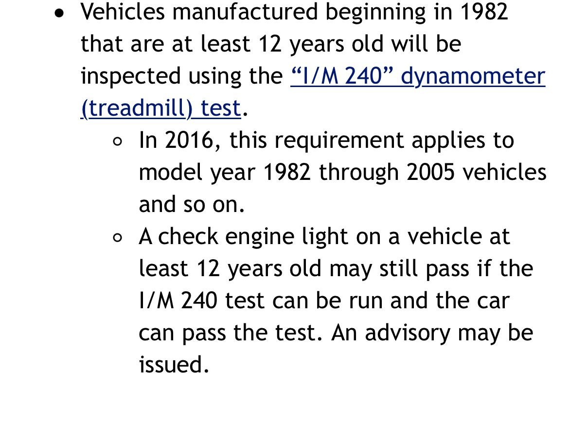

They don’t give a shit about the CEL at all, apparently.
Still failing on the rollers though…
From CO’s website;
