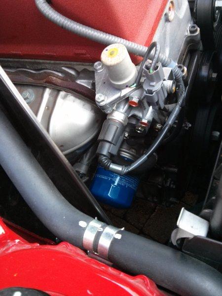

This is the switch in question:
I noticed in another thread someone had done the same thing and got a CEL.
H'mmmm, maybe it's not the switch. Anyone run into this before?

lol, i write, ( not seeing ), you post a pic.. timing dude, rocks... man, that's a clean looking engine.... and exactly.. let's see what some other have run into.. maybe you can pm Billman..
