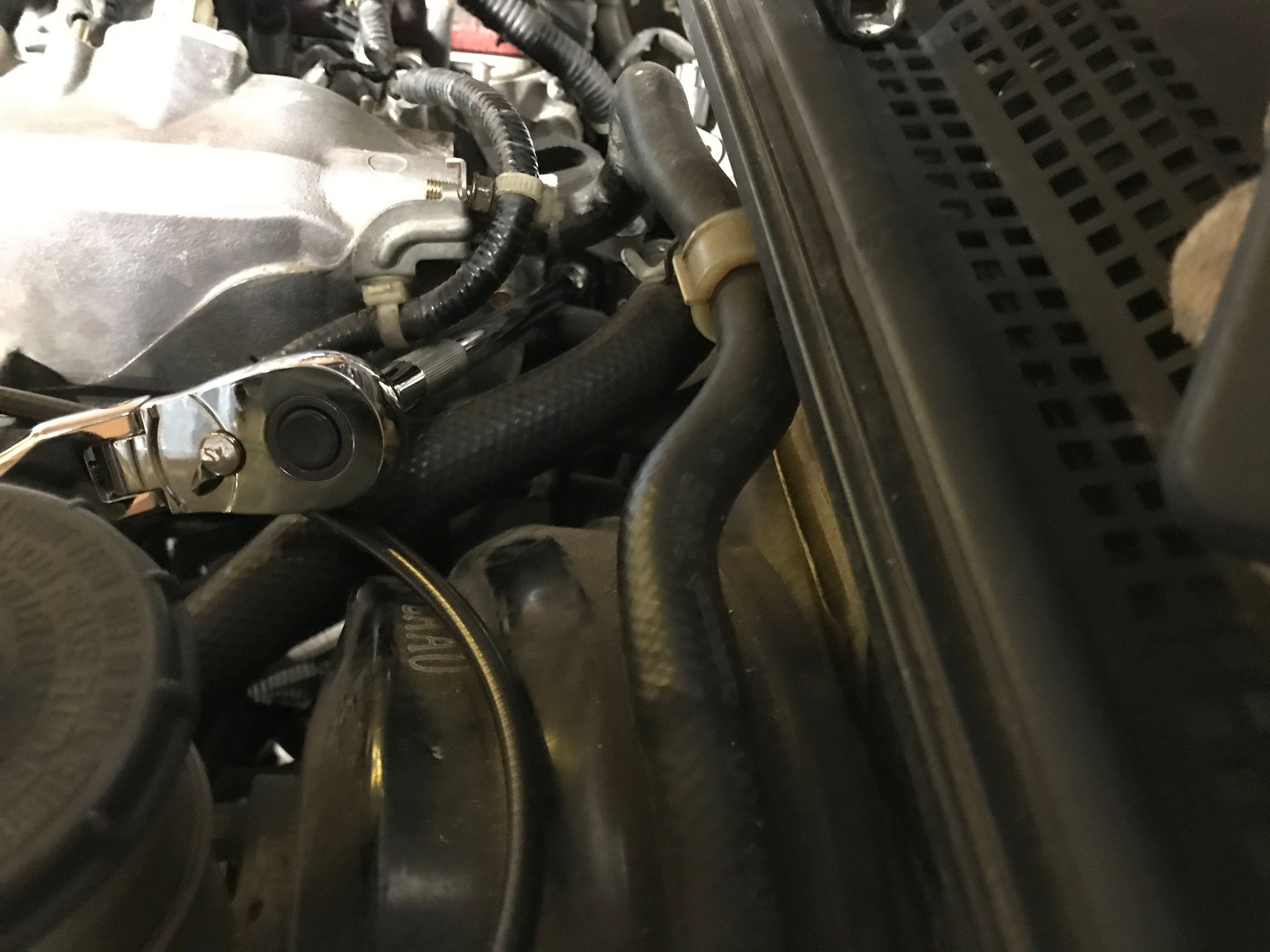

I just finished removing the lower bolts. As a hobbyist, it was a 10/10 in frustration. I'm adding pics to hopefully help people save time in the future.
For the 4th bolt under the last pipe, you can access it from the top with a 12mm -> flex joint -> extension bar -> 3/8 ratchet.
For the lowest bolt on the far right, it helps if you remove the air control valve so you can reach around and guide the extension bar with your free hand.
