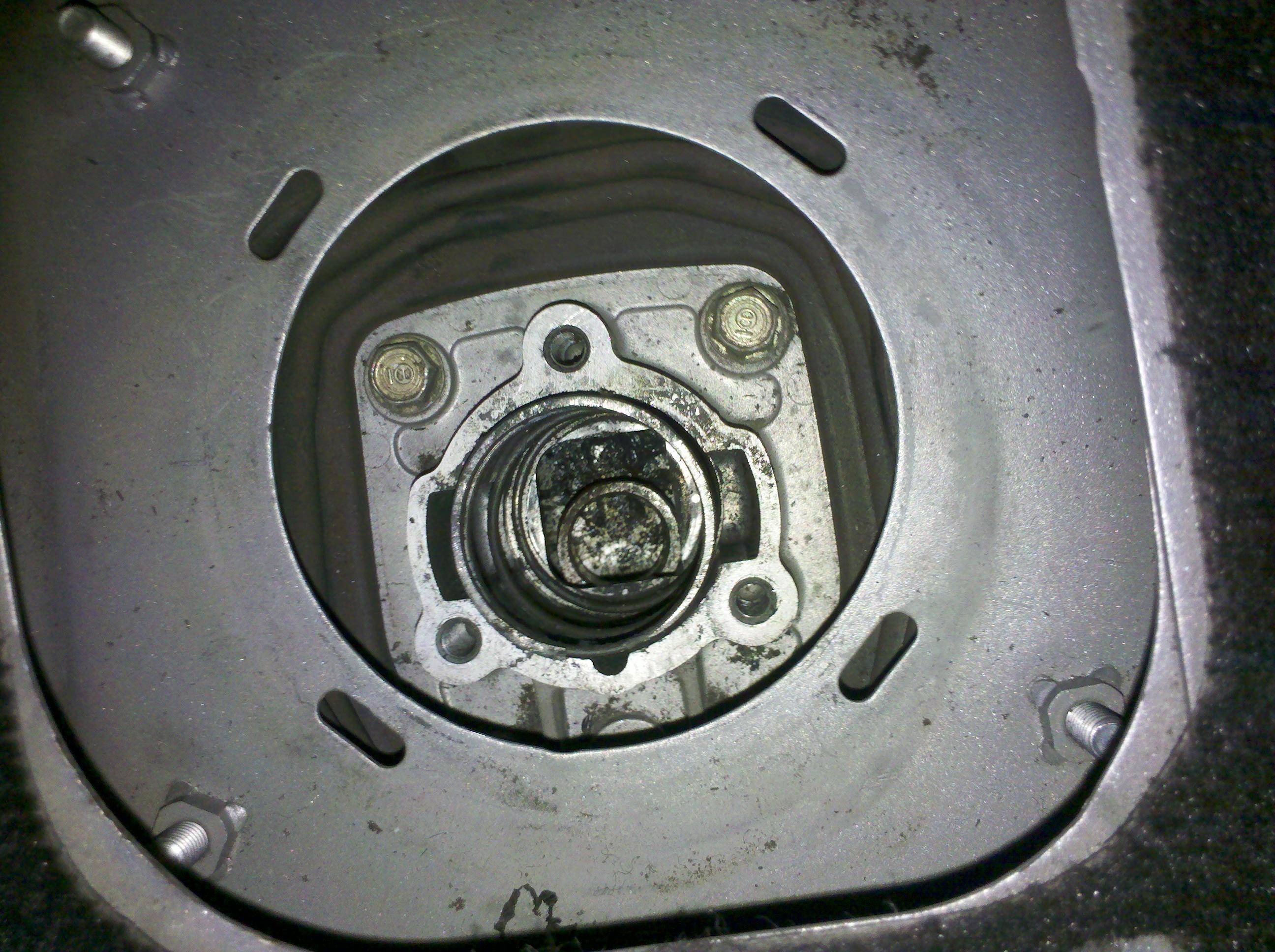

Well it made a big, big difference for me. Dropped 1/2 of the urea grease in there and around everything (after cleaning up the crud).
Here's what it looked like. That's why you check /change everything when buying second.
It's so smooth I went through a tank of gas in 2 days.
