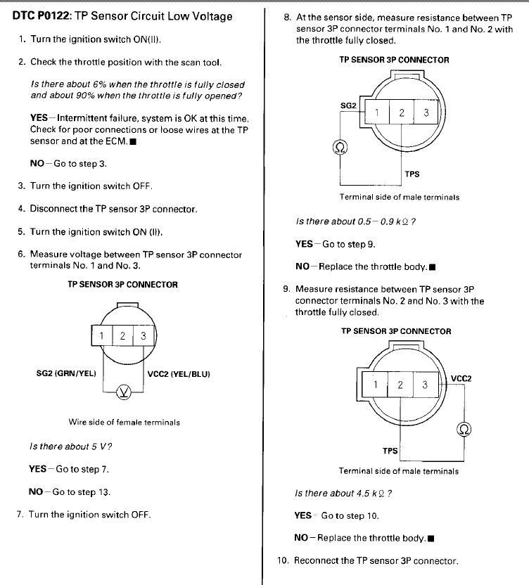

Originally Posted by ShocK,Jul 27 2007, 10:08 PM
Stock TB? there are two screws holding it into position, unless you have the special tool you wont be able to turn the screws, I used a small chisel and hammer to break them loose, my TB came with new screws. You also need a diagnostic scanner, the TPS must be set below 14% at closed throttle. Mines around 12%, Then you need to reset the ECU and perform the idle procedure. 3k rpms until the cooling fans kick on then let the car idle for 5 mins not including fan run time any time during the procedure. Stupid but it really makes the car idle nicely, especially if you have the TB and all the crap I do.
That is not correct - the TPS should be at 6% closed and 90% WOT
Below 4% you will get the TPS low DTC, above 9% and you will get TPS high DTC.

If you go to the page before that it says below 14.1%. The whole thing is confusing to me, some of the stuff in the manual contradicts itself. I definitely have a flat spot around 6% so I'm tuning around that. I havent gotten a code yet.

[QUOTE=ShocK,Jul 28 2007, 12:11 PM] If you go to the page before that it says below 14.1%.

I'll keep an eye out on mine, if no code then I'm leaving it.
