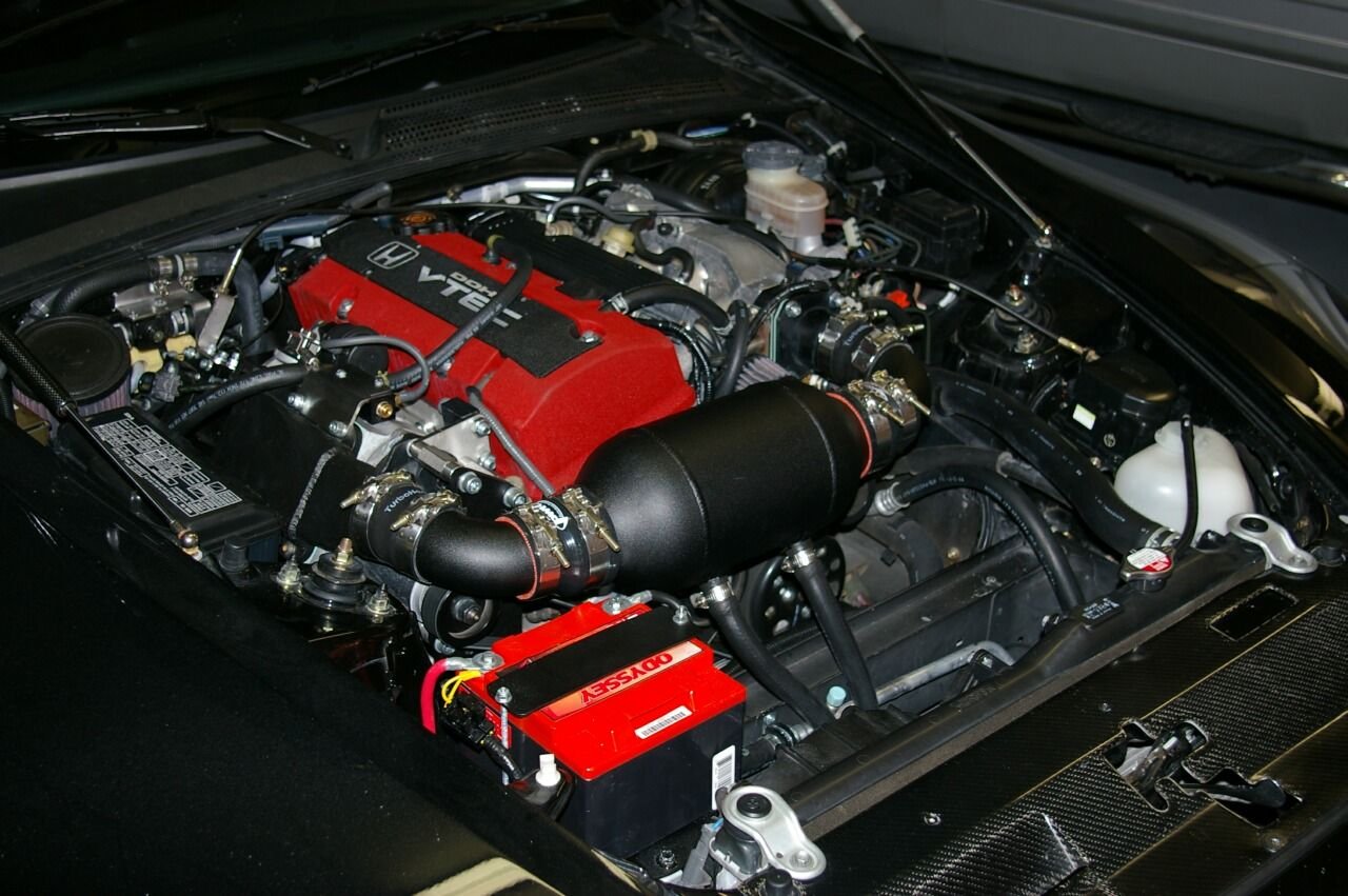

It may help some, but I do not have that little slit in my TB leading to my MAP sensor. My Map sensor is mounted in a dummy TB:

Originally Posted by WLAURENT,Aug 10 2007, 03:39 PM
Here is his fix- https://www.s2ki.com/forums/index.php?showtopic=515674
wtf is that? lol Where is your throttle?
My map passageway is open since my intake was bored out a little too much. But it could help some people, who knows.

My Throttle is in the upper left corner of this picture.

^ Can you explain briefly what you did under the hood? Looks nice and tidy!!!

supercharged?
As mentioned - Roots type SC
You can learn more here:
https://www.s2ki.com/forums/index.ph...f=142&t=467853
