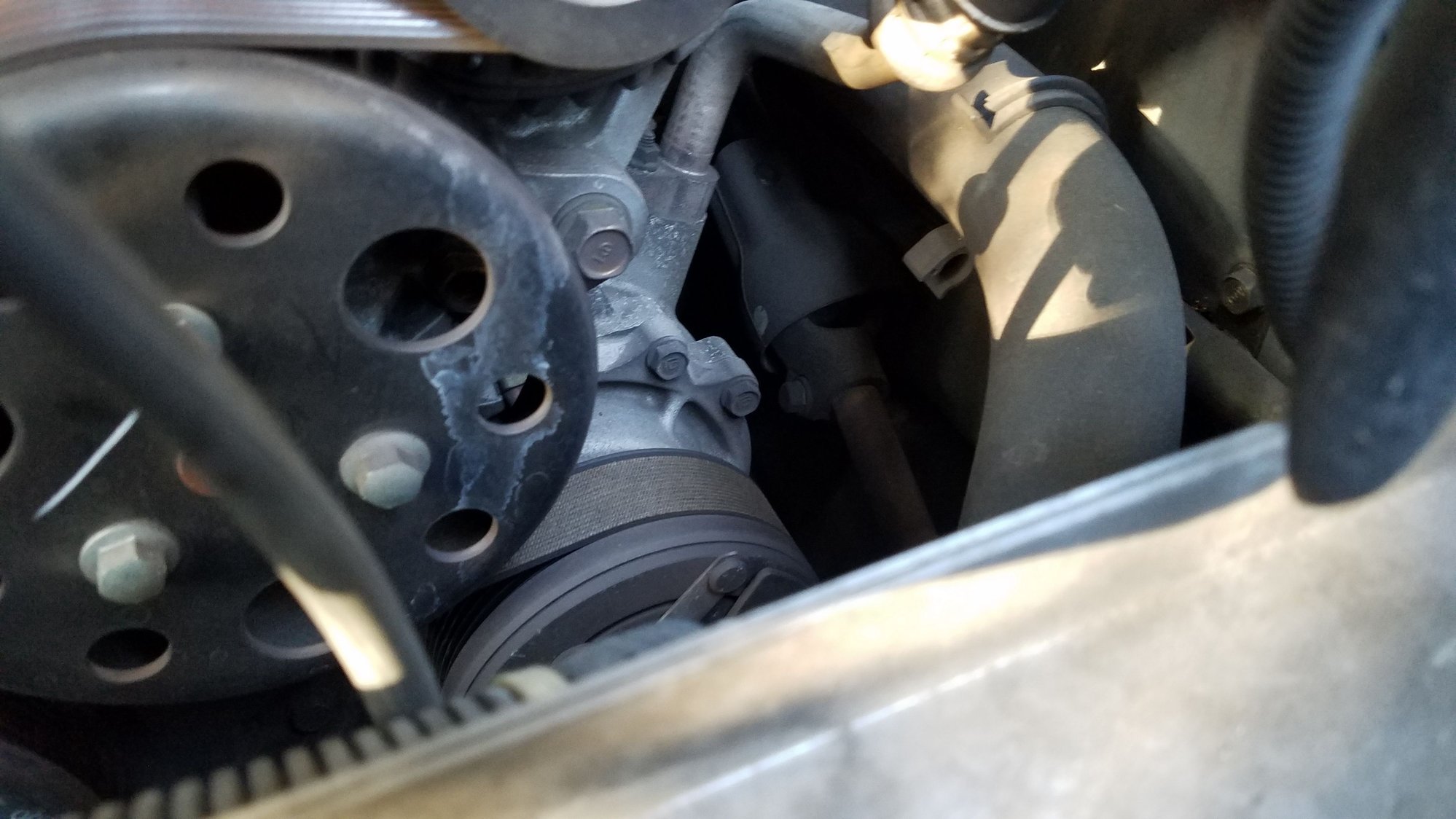

Thanks man!! im going to apply the grease soon hopefully!! if by any chance you happen to be under your car sometime soon could you try to take a picture of what i should be looking for? i really appreciate it!!
You can actually see it if you look straight down inside the engine compartment Follow the steering rod to the right and you will see the dust cap that slides back exposing the area to lubricate.

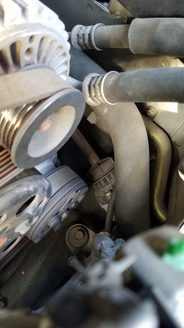

From looking at your picture and looking at mine are looking at the samething? I see where yours is lubricated and mine is dry as a bone... I just want to make sure I'm looking at the right thing haha
Or are you referring to this
​​​​​Cause when you say to the right I'm not sure which side your standing on haha
:edit: NM it was exactly what you were looking at I just had to stop being a little baby and stick my hand down there... I didnt do it the first time cause i just got home from work so the car was still HOT... lol Im not sure how much grease you used but I worked a good bit on the bearing then drove around the neighborhood a bit... Couldnt exactly reproduce the issue but it comes and goes... Will dive the s2000 to work tomorrow and see how it goes.

Great .. thanks for your photos.yep that is it. The grease you see on my photo is on the outside of the unit just because I didn't get it all off. . Just to make sure, you did pull back the grease cap and then apply the grease? Correct? Then slide the cover/cap back down the shaft..
Please let me know how it turns out. It does take a few miles to get it all worked in.....Good Luck!!
