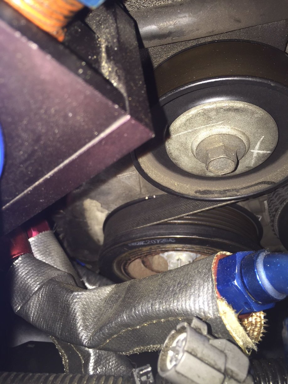

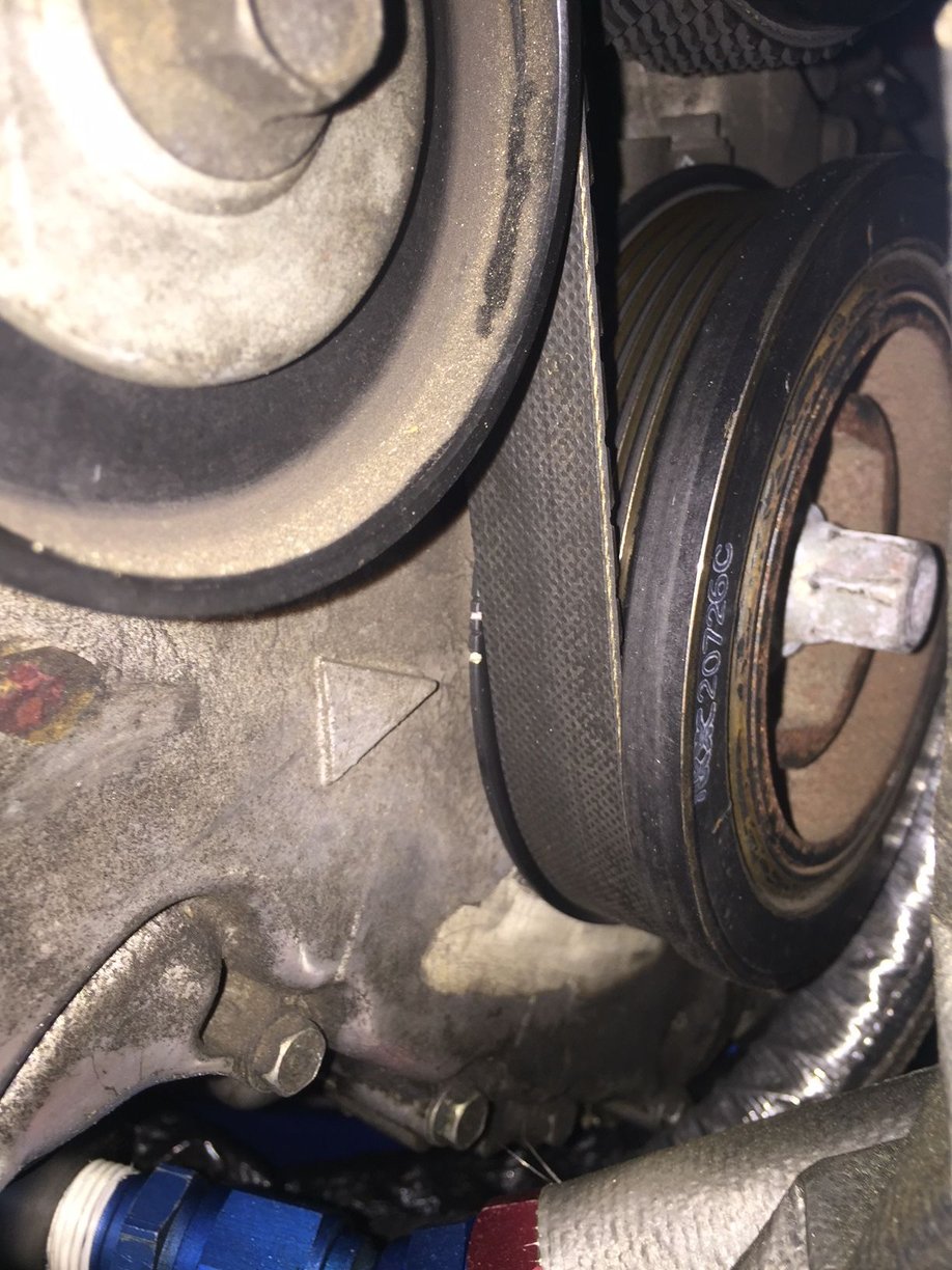

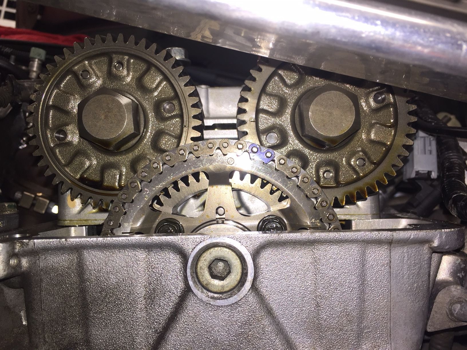

I just want a sanity check on my timing marks. This is the first time I've removed the camshafts (valve seal replacement) so I just want to make sure I got the timing correct - I think it's good but as a first timer I'm still nervous!
Cam timing marks before I removed everything:
Crank shaft marks (note that to get the cam marks to be flush with the head, the crank mark was a little off):
And now after I put the cams back on (note the cams are not tightened up yet so that's why they are not fully seated into the gears):
Crank marks:

Good, guaranteed.
