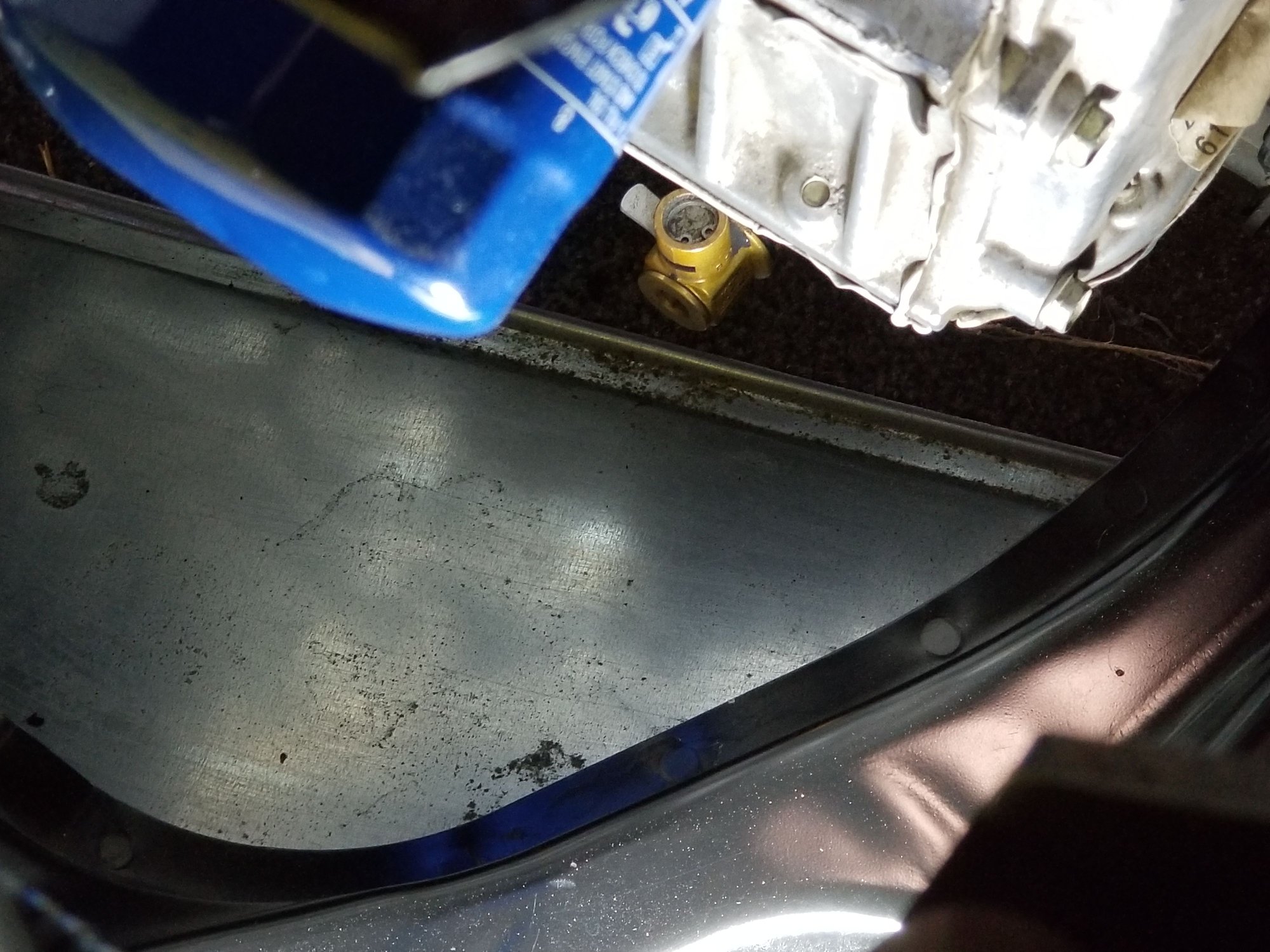

You can bypass this entire problem (for the oil pan bolt that is) by using a genuine Fumoto valve so you never have to remove or replace the drain bolt. If you slide a shallow pan under the car ( I use disposable aluminum chafing pans) you don’t even have to get under the S to change the oil. It can all be done from an open hood.
You don’t have to worry about it getting hit by something and leaking. If something hits this in its location enough to cause a leak, you have much bigger problems! I have one on my 1999 Jeep Grand Cherokee ( I call it Elizabeth Warren- It is white but it says it is a Cherokee) and it is well protected even off road.
