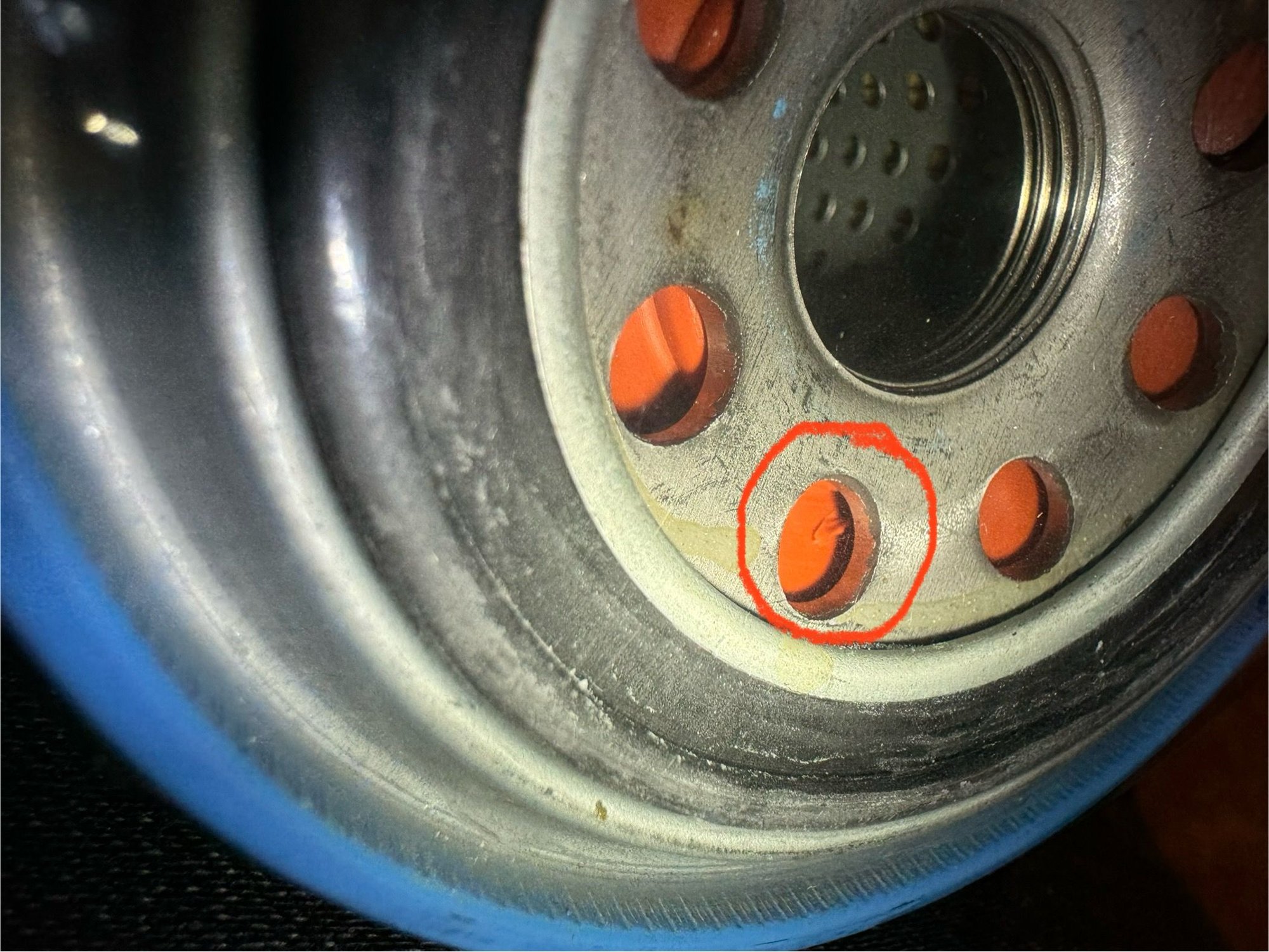

And while on topic of these filters, I have to mention the lousy anti-drain back valves. Ive had several that do not seal and drain the oil back to the pan overnight. Ive wasted so many filters because of this its ridiculous. The oil light will stay on for a second longer than it does with a good filter drain back valve. And its of no wonder they dont work sometimes. Ive found them with chunks of silicone stuck to them and given these chucks were in the sealing surface, it would hold the silicone valve back and allow the oil to drain to the pan. Pull the filter off and theres almost zero oil in it after sitting 8+hrs. Then Ill change it and I might get one that will hold the oil overnight.

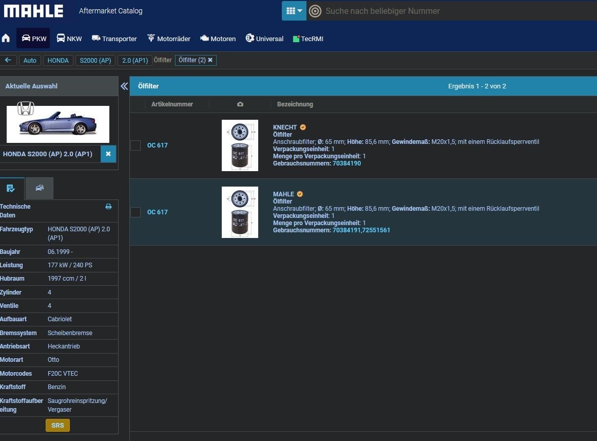

I like the Purflux LS 350 or MANN W 610/6. US / Euro style square gasket.
Have a look at the Mahle Germany Aftermarket online catalouge. I asked them how the OC 617 Filter compare to the PCX-306 and they told me that they are equal. The OC 617 fits every Honda beside the Legend and NSX.

[QUOTE=Mr.Matchbox;25126187]I like the Purflux LS 350 or MANN W 610/6. US / Euro style square gasket.
QUOTE]
I did and they look like they have the standard gasket and not the metal ring sandwich the OEM Honda has. Do you use a safety wire then?
