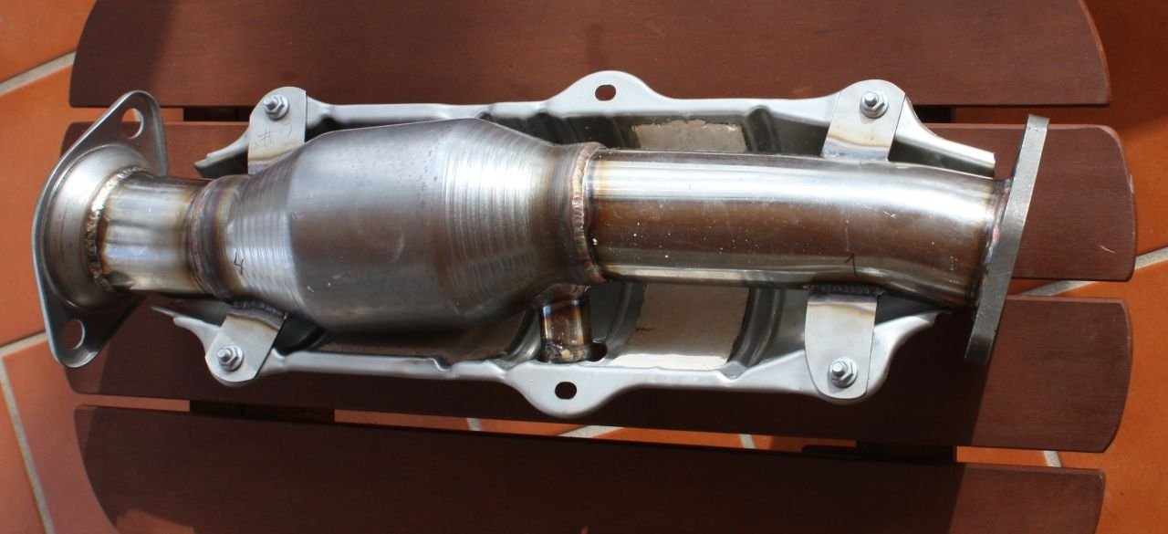

I've been running heatshieldless for the past there summers. A chunk of concrete ended up under the car at speed, smashed into the headshield, and broke the mounting tabs on my high flow cat that held the shield in place. OE heatshield. Horrible rattle. Took the shield off intending to reweld the tabs back on the cat but...
This is what the high cat and heatshield looks liked before the concrete chunk ended up under the car. Half the shield removed to show the mounting tabs.
The cat is below the right footwell and there should be insulation on the bottom of the body. I've measured the temperature under the carpet and it's not excessive despite lacking the upper heatshield on the cat itself.
Not sure I'd want to park in a field of dead grass without the heatshields though.
