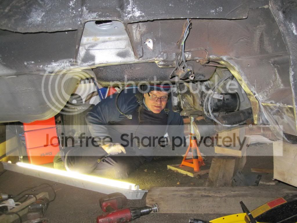

A few silly pictures of man in the garage , and just to make MR Pitts jealous tea and crumpet!

Bloody Ell! We are like brothers from another mother I'm sure I've seen more of the bottom of my car than the top. If you changed the person for a good looking dude it could easily be me under there. .

SO what are you inferring MR Pitts!
At least your bottom is cleaner than mine
