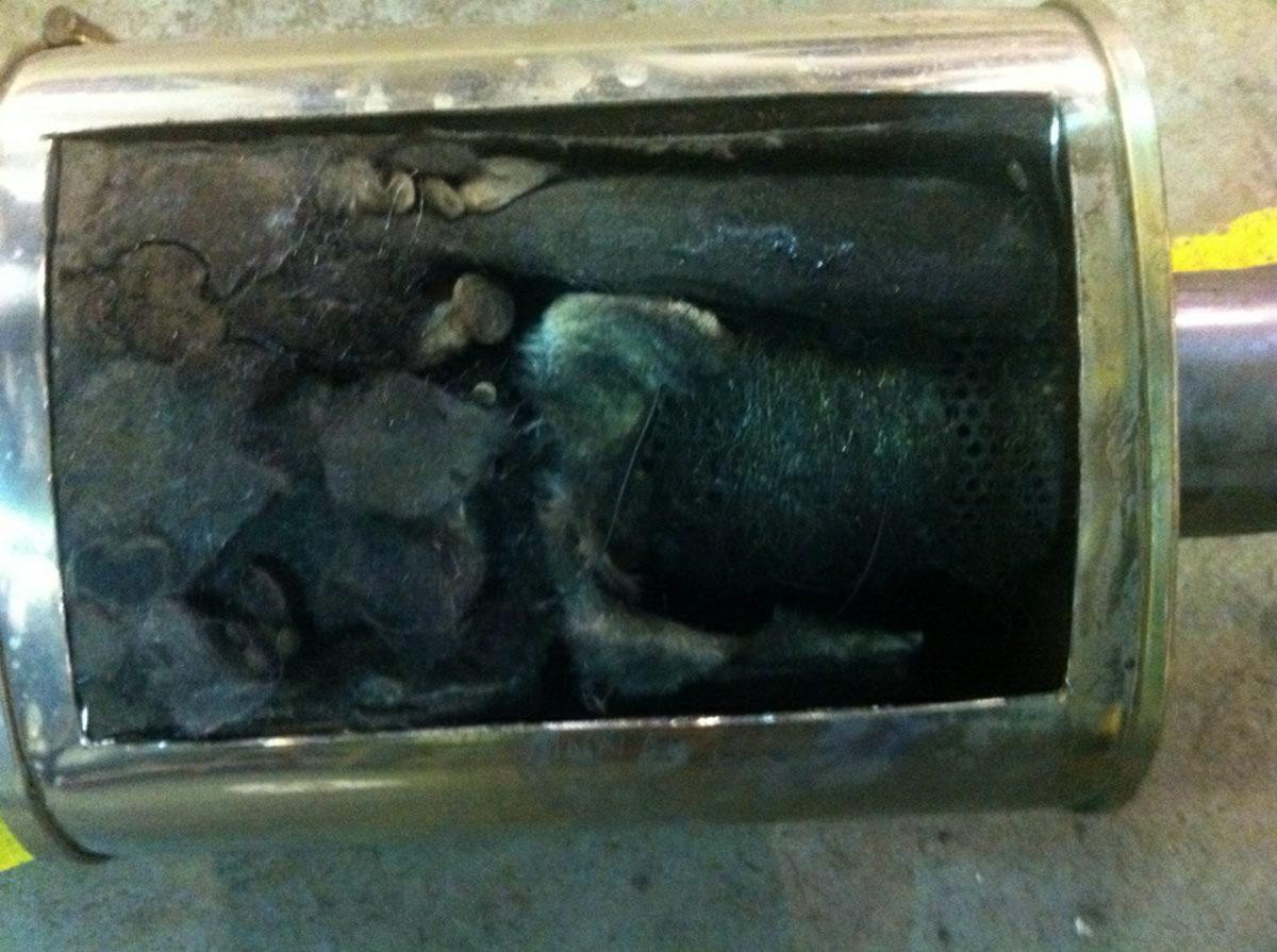

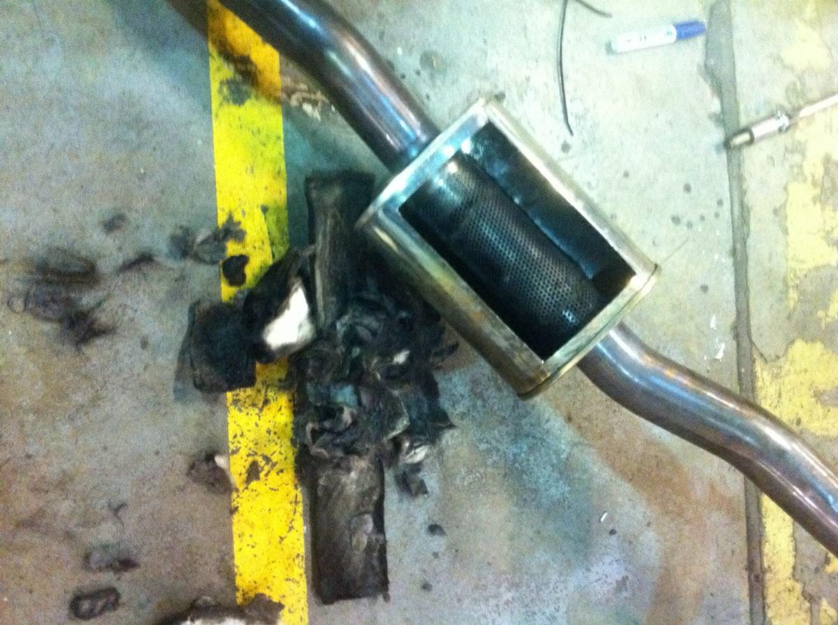

Got a load of things done today, while I sat and watched TV (thanks Veysport )
Walbro 255 (ready to die) removed and put in the bin. OEM pump fitted (thanks Mr Pitts)
4.44 diff bedded in and oil changed for Motul PA90
Blocked washer jet unblocked
Yellow box calibrated on the dyno
And my ASM had developed a rattle... which was fixed using some old fashioned methods!
Very common on these for the 1st silencer to start rattling. Cut it open and found all the packing had broken down and the silencer tube had cracked.
Removed all the shit and re-welded the tube Bit more noise, which I wanted Gas flow wise it may have been better to remove the box and weld a band of stainless sheet around the perforated section, but it will be fine.
