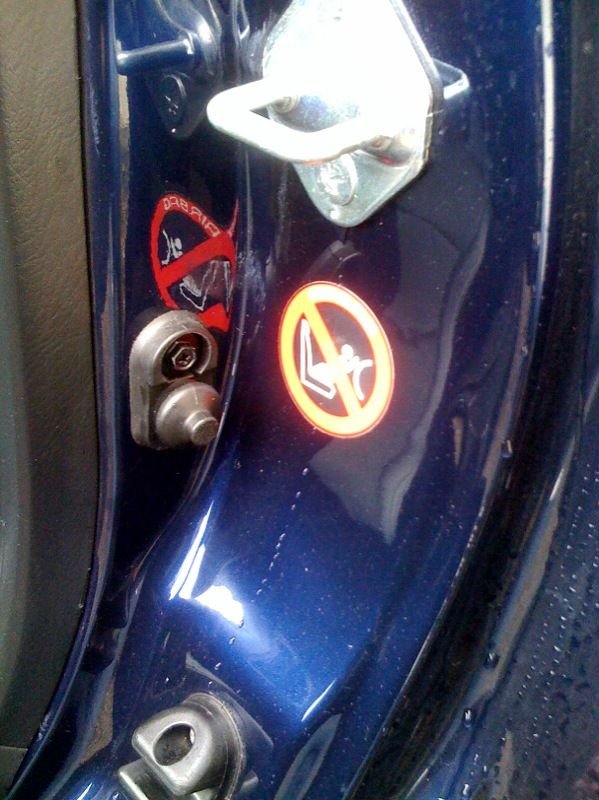

im having this issue as well, but mine seems to be with the connection, ....because if i press on the switch(apply pressure) it comes on, i let off and it goes off. however it stays on if i slide it to the "on" position. just doesnt come on when it should such as the door being opened. Would i need to pull off the cover and clean the contact point on the bulb or is it something else???

Contact switch is on the door frame, at the back, there is a rubber circular bit. Switch is in there
..... and they are crap. I've replaced both of mine already. The switches are not expensive either, not worth cleaning them up.
