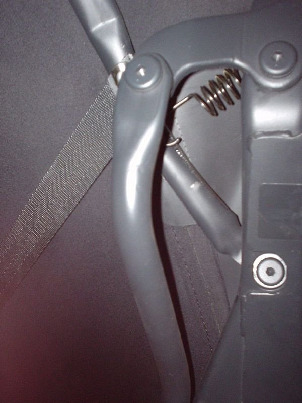

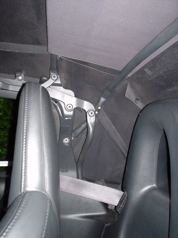

Forgot to have a look ..... but just been out with my torch and camera...
Is this the strap?
If these springs were not in place this strap would sag.....
Any use?

Many thanks Steven.
The problem though is that the bar is coming to far forward. The strap appears to stop the bar as the hoods going up. It's sitting about halfway along the cloth part in your picture.
I reckon the problems that they're not attached properly under the trim.
Looks ike I'll just need to take it in to the dealers.
I was trying to figure out whether the attachment under the trim was adjustable or fixed. ie: how big an issue is it.

Those springs were an addition to 02 model to cater for the rear glass window.
I remember that if you put an 02 hood onto an 00/01 frame you needed to improvise the springs to get the hood to fold down correctly.
