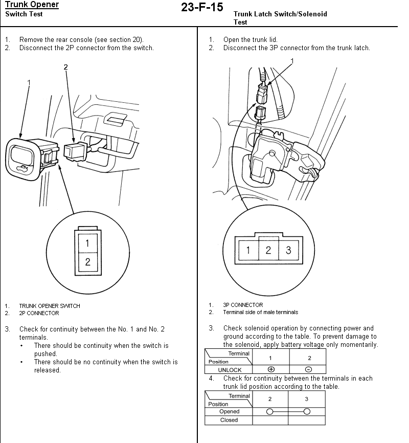

The internal boot release in the glovebox I dont think is electrical, so It may be the boot catch itself or someting.
You can get a new keyfob, they just need reprogramming to the car, this can be done, Crown did it in front of me

Old Mar 21, 2004 | 10:45 AM
AquilaEagle's Avatar
Administrator
Posts: 95,183
Likes: 69
From: Heath & Reach, Beds, UK

Ian - where do all these amazing diagrams come from?
Old Mar 21, 2004 | 11:23 AM
Administrator
Posts: 95,183
Likes: 69
Workshop manual
The internal boot release is definitely electrical. If you look at he wiring diagram you will see that the boot solenoid is operated electrically from the glove box switch. If it is the remote boot release AND the internal boot release not operating the boot release, then it must be the solenoid or the wiring to the solenoid.
I can tell you how to diagnose this problem, but I need to be sure that you know about electrics/car electrics/electronics, because you could do more damage if you are not sure on what you are doing.
If you have no idea about electrics then play safe and take it to your dealer or a car electric specialist. It shouldn't cost you too much to get fixed.
PM me if you want any more info and you feel happy with diagnosing it yourself.
