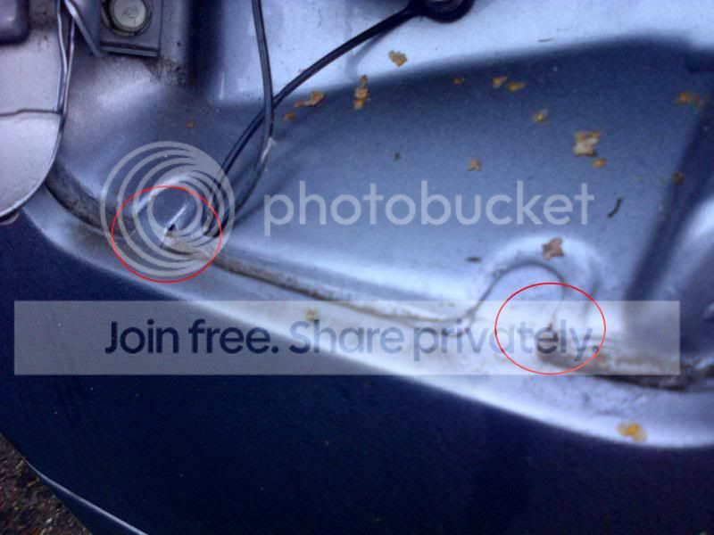

OK, so the drainage pipes seem to be clear...
Inside the petrol cap, there appear to be little holes at the bottom welds:
Could the water be coming in through here? And if so, what's the best way of stopping it... don't want white silicone all around my filler cap!

Although they do look like holes I would be surprised if that much water can get in through them!
In any case fill them with body filler, and then use a touch-up pen of the correct colour.
