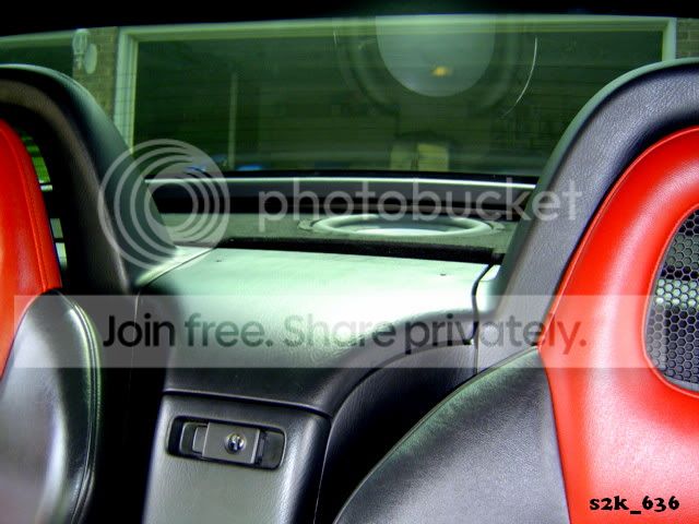

Has anyone installed subs behind the seats "or" were the plastic tray is for the hard top to rest on when its fully opened? Having my car in pieces that gave me the idea of taking the soft top out of the car and using this area for 2 small subs 8" or 10" for a clean tight bass. Looks to be plenty of room for a small free air sub just want to make sure that it can hold the weight of the sub or subs.
I installed a sub box that holds a 10"sub and next to it is my amp rack. This is my second set up. Unfortunately I don't have a pic right now, but I can probably provide it in a week or two, since I'm re-doing my set up. I plan on going back to my old set-up where I can retain my spare tire. My new set-up currently takes all the space which left me without a choice but to remove the spare tire. Alpine Type R subs is pretty darn big. Here's a pic of my first set-up.

I have yet to try a shallow mount sub. I'm actually going to take my chances on that this coming winter when I redo my set-up. I plan to get the 10" Kenwood xrw10f. I remember talking to Urmil one night and he showed me a shallow mount sub, but I can't recall what it was. According to him it was pretty good. Then again, I like to hear it for myself and rate it.

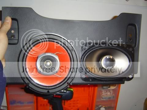

You could also add some speakers behind the seats. I know a few of us midwest owners are doing so. I was able to fit a 6 1/2 and a 4x6 on each plastic panel( totaling 4 speakers behind me). But I wouldn't recommend doing this if you're tall since you need all the leg room you can get which may require you to move your seat all the way back.
Here's a pic of it:
