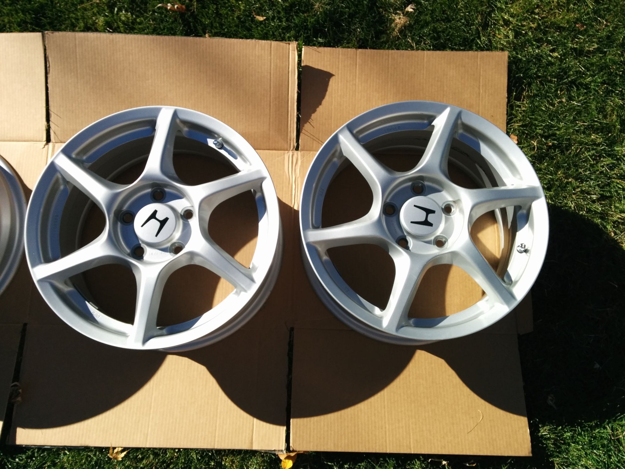

BTW - I just picked up a set of JDM BBS ap1 oem wheels, (16"). This will cut some weight and improve the look of my 16" set up a bit. I'll try them out for a season. Sadly, I have to wait about 5 months! Ugh. My S is in hibernation. Depending on how they look to me once I get them here in the garage, (they are being shipped to me now), I may have them refinished over the winter. This may be my ultimate set up. For now anyway. I'll order a set of tires soon - probably either the Continental ExtremeContact Sports or the Firestone Firehawk Indy 500s. Both of these tires get good reviews from S owners, they come in the right sizes, and they are reasonably priced.
Flame away! I have my fireproof suit on.
Edit - add pics of new 16" wheels.
