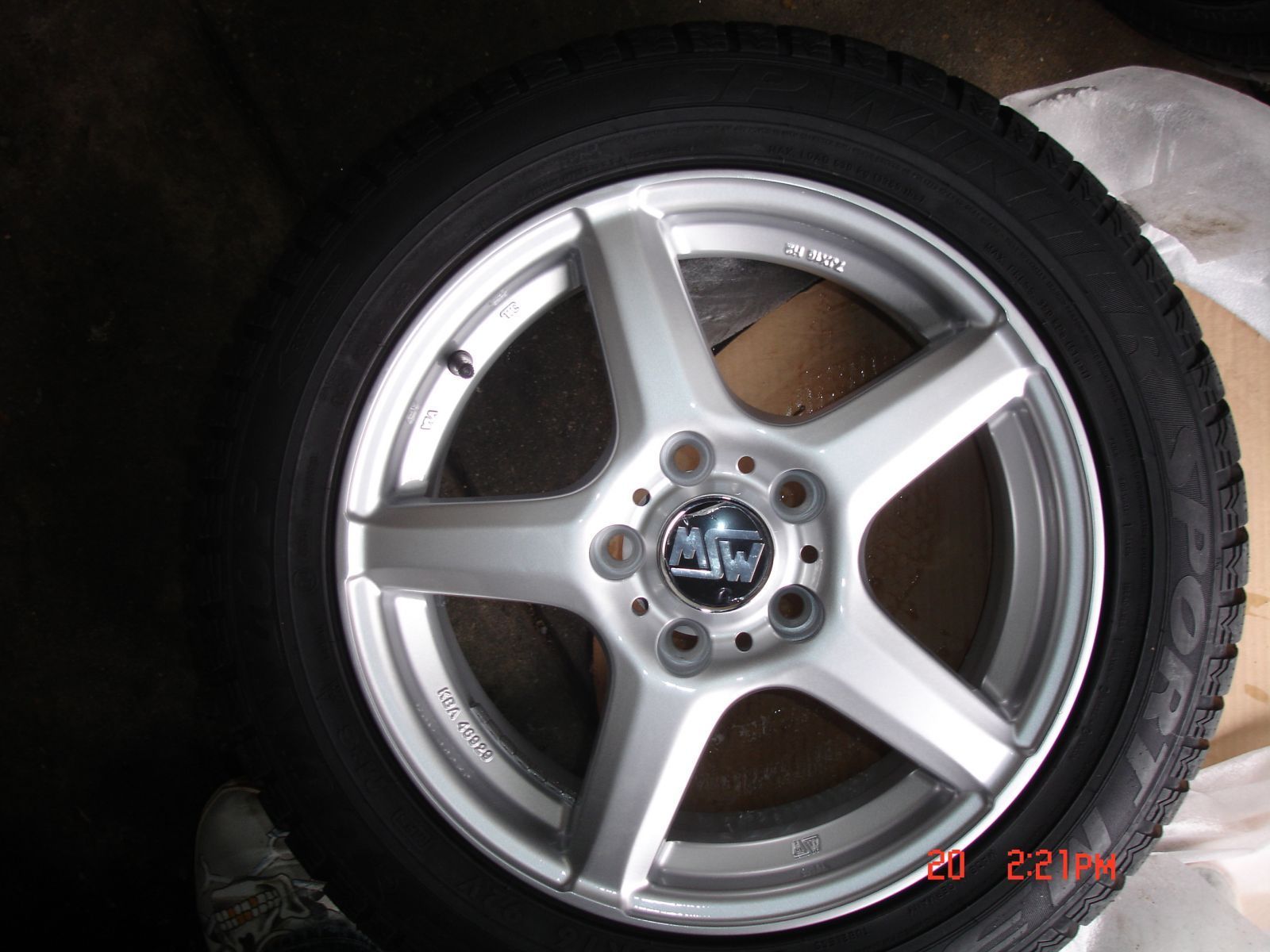

We get rough snow only a few days each winter but it can get really cold.I'm one of those who has to go when it snows and I can't wait for the snow plow. Jim sold me this setup last year; it's a 16in wheel setup for my AP2. I love them.

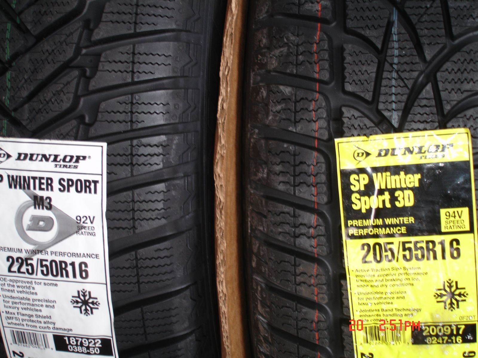

Originally Posted by Chris Stack,Sep 28 2009, 03:38 PM
I've got a set of 4 Dunlop WinterSport M2's, and the rears one of two kinds of WinterSport 3Ds (one for $98, one for $108) or M3s for $138. (all prices on tire rack)
Clearly, I'd like to just get the $98 WinterSport 3Ds, but not if there is a compelling reason to get something else, or get 225s.
Yes, you can run 3Ds in the back.
The $138 is a run-flat (ROF) and you don't want that.
The other two differ in speed rating, load rating and weight:
$98 H rated (130mph), 1356 lbs (load), 21lbs (tire weight)
$108 V rated (149mph), 1477 lbs (load), 23lbs (tire weight)
I just ordered a set and got the V rated. H would probably work but I'd consult the tire rack on that.
There is a new $50 rebate on Dunlops through 11/29:
http://www.tirerack.com/specialoffers/deta...sp?promoID=D975
