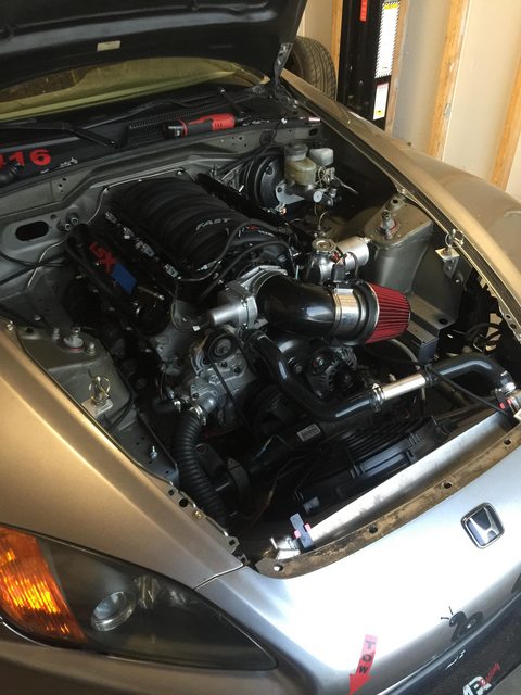

I am nearing the end of my built 6.2 swap and want to compile my knowledge while it is fresh. I will avoid pimping brands since I am a big fan of almost everyone doing parts for this swap. I will just mention when a solution is available and when ingenuity is required(or both!)

The engine is a pushrod lump of aluminum and is much lighter than a 2JZ swap. I suspect if you kept all the garbage in the engine bay you might add a three 30 packs of beer worth of weight. Removing all that fancy AC/Airpump/etc clutter gets some of that back then putting a big battery in the trunk removes the rest. This engine sits entirely behind the center of the shock towers so it is nothing like a miata where 1/3 of the motor is on the nose.

The S2000 is a better chassis than the Miata for this swap because the engine *does* sit further back. The Miata has an advantage because the end result is so much lighter. My Miata weighs 2400#, which is about 450# lighter than a stock S2000.
The LS is a *great* engine. When you get yours running, you won't be able to wipe the smile off your face. Very nice build.

<snip> This engine sits entirely behind the center of the shock towers so it is nothing like a miata where 1/3 of the motor is on the nose.</snip>
