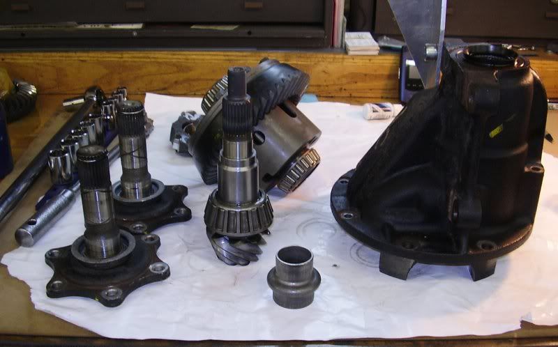

This pic is of the PuddyMod solid steel sleeve on the pinion. The factory crush sleeve is just to the right front for reference

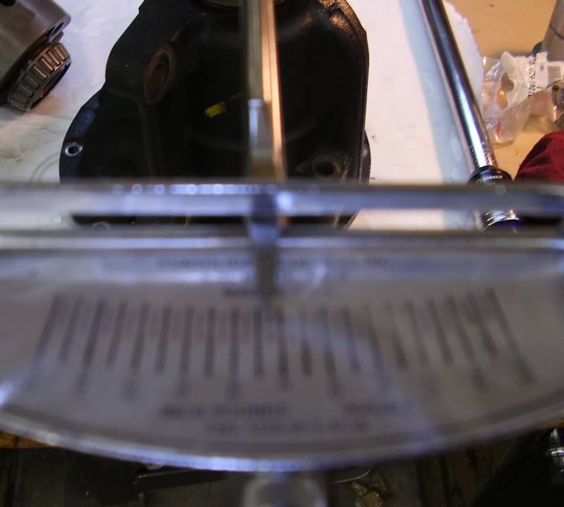

This pic shows the turning torque on the flange after the PuddyMod solid steel sleeve is set. The torque is set at 12 inch pounds.

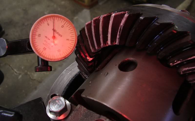

This pic shows the backlash and gear to gear pattern, backlash is set at 3 to 3.3 thousands, the pattern looks great.
