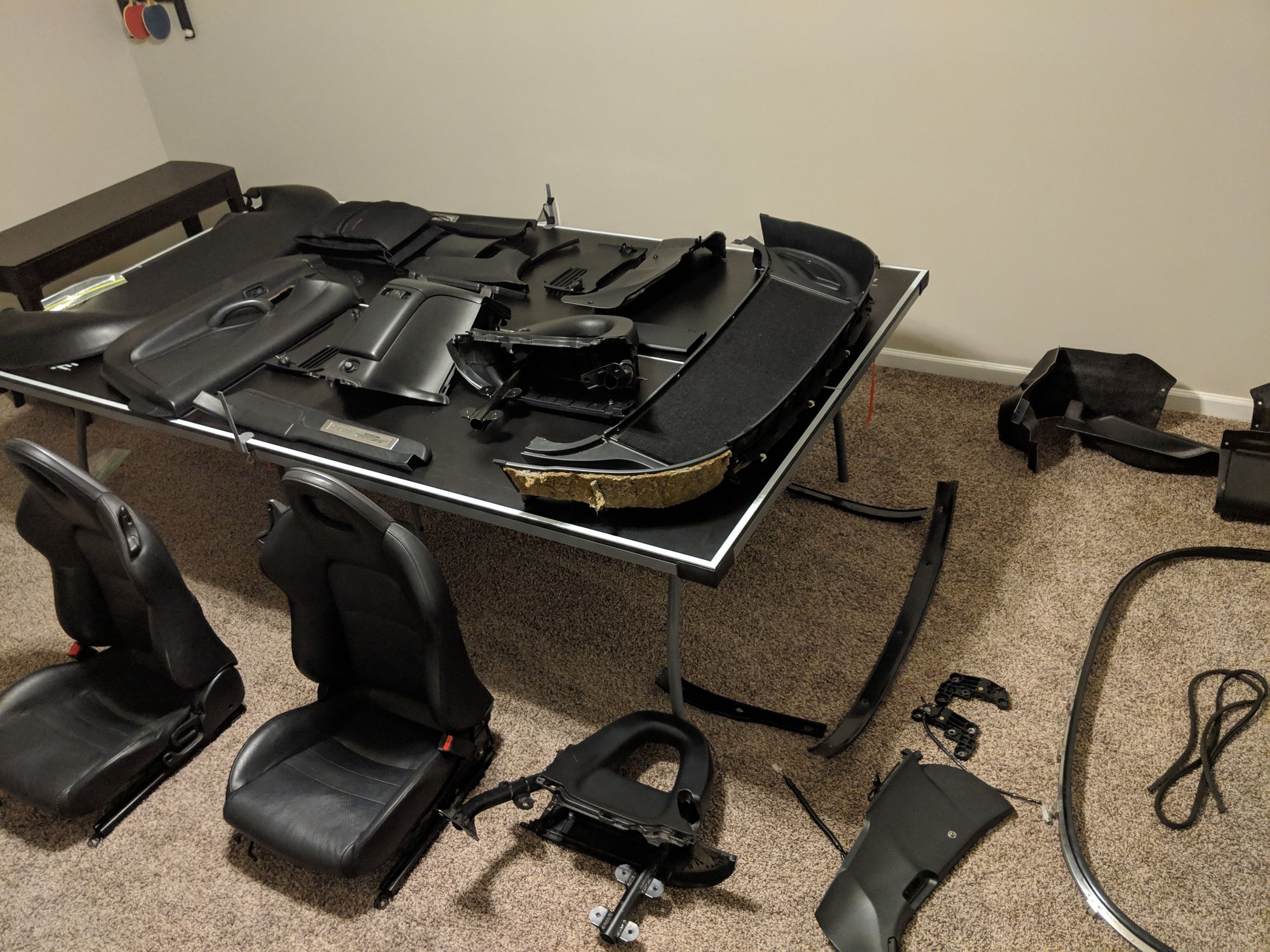

incase anyone is ever curious how much your car has to be disassembled ONLY to remove the rear moulding for painting.....

How many hours do you think you have into this repair project? Keep us posted on the progress. It is cool to see a pictorial as the project continues.

Disassembly probably
- Remove Front Lip
- Remove Front Bumper
- Remove headlight & support
- Remove fender
- Remove Rear Bumper
- Remove Trunk Liner
- Remove passenger tail light
- Remove Passenger Trunk Garnish
- Remove passenger kick panel
- Remove inner door card
- Remove Power Mirror
- Remove Inner Door handle
- Remove speaker
- Remove door moulding and weather stripping
- Remove Window
- Remove Door Sashes
- Remove Window Regulator
- Remove window stops and guides
- Remove exterior door handle
- Remove Latch assembly
- Remove Door Wedge
- Remove Soft Top Tray plastics
- Remove Rear Soft Top Frame & Rain Channel
- Remove Door sills
- Remove Rear hook/vent panels
- Remove B pillar garbish
- Remove center console
- Remove Rear Glovebox trim
- Remove Glovebox
- Remove Roll Hoops
- Remove Rear Gussets
- Remove Soft Top
- Remove Rear Deck Moulding
probably 19 hours as I've bagged and labeled everything in the process...
Paint & Buffung & blending, probably ~ 20 hours. Then reassembly and proper torque, as well as adjusting will probably be another 19-25 hours.
So 60 hour job... lol lots of beer.

That is a lot of hours. I guess it gives you a chance to further deep clean the car since you can clean and/or refresh each part/nut/bolt individually during the reassembly. That would be satisfying for me as I really appreciate clean everything.
