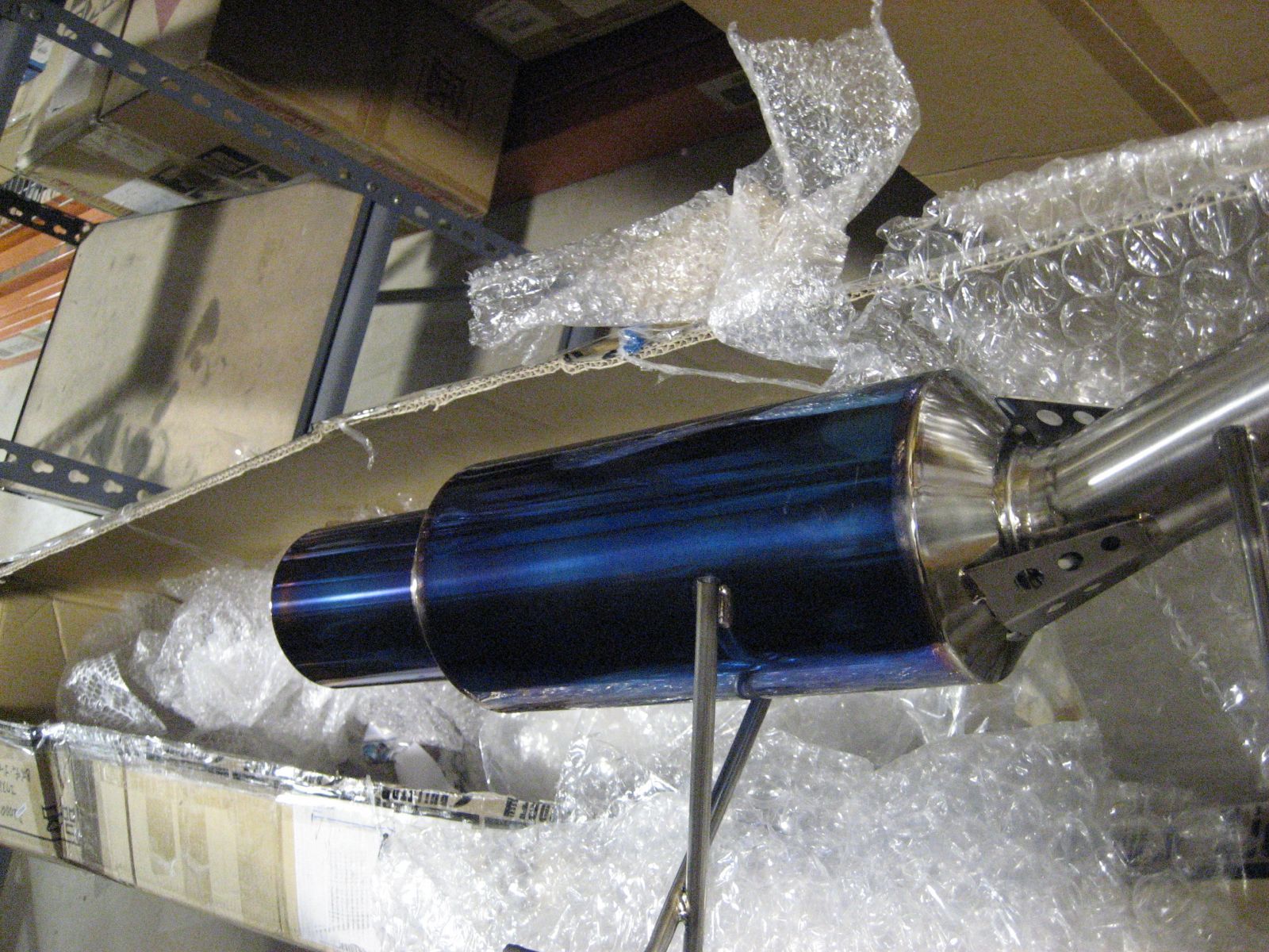

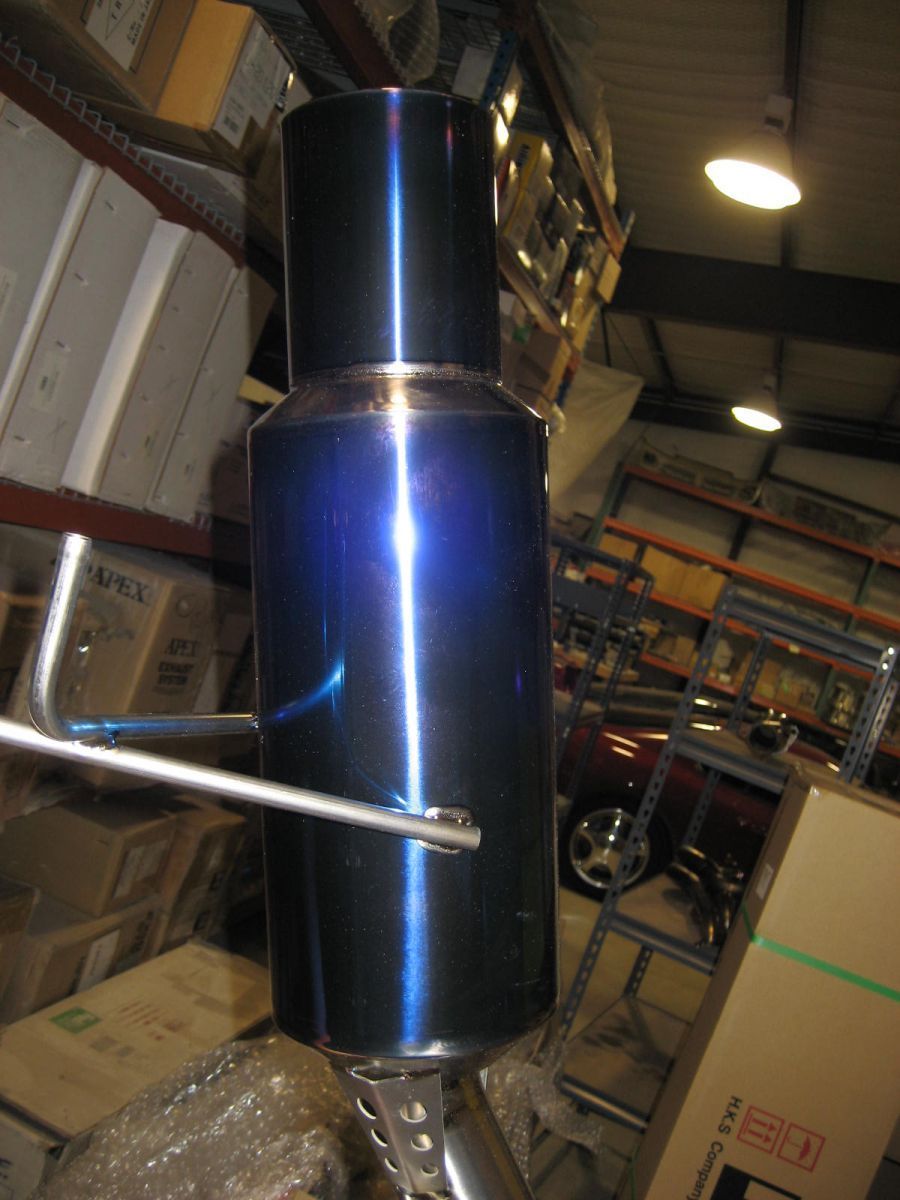

That is correct. When we weighed the Amuse products, we weighed them while they were still packaged. I prefer not to weigh a client's titanium products while exposed unless I have latex gloves. The oil on a person's skin will transfer onto a titanium product and if the product isn't thoroughly washed after handling, the moment that exhaust heats up the oil will be permanently burned into the exhaust forever. We made an exception with the cat when we took pictures because it is so rare. Of course we thoroughly cleaned it afterwards.

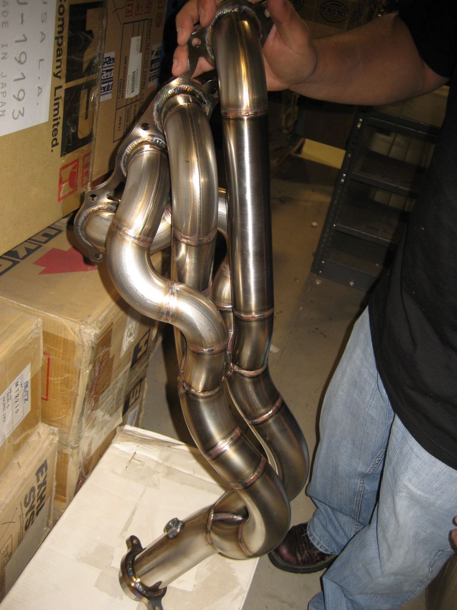

Well guys, here are a few pictures, and the dyno results from the install. A little less than half of what hoped to get power wise (from misc. info. gathered from different threads), but what a weight difference! The exhaust weighed in at just 9.5 ibs. compared to the almost 50 ib. factory exhaust. The guys that did the install (MVP Motorsports at Bridgeport, TX) were absolutely blown away by the quality of the welds (all hand welded). Anyway, check it out.
Hope this info. is helpful to everyone!

I should have some sound clips/video up very soon. This set up sounds sounds VERY agressive even w/ the resonator! I love it!

Very nice stuff, Mason! I love that exhaust manifold! I really want to see that setup with a good tune, I feel like you'll get some major gains. This is just the start.
