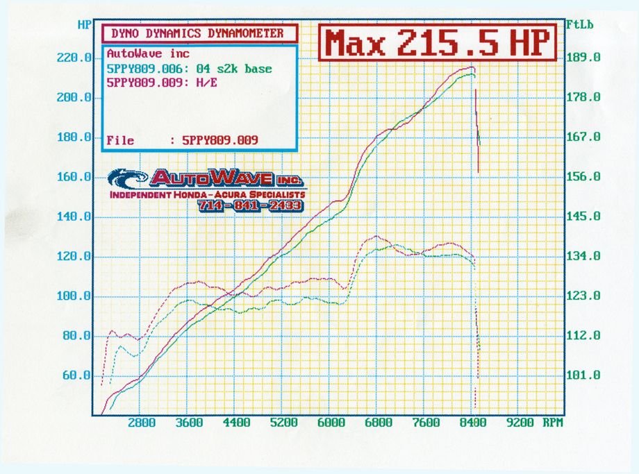

Gutted airbox
TracySports header
Fujisubo Legals R exhaust
Before and after plots:

What's with the odd dip at 7k?

That's a good question, the A/F ratio wasnt recording on the dyno that day, so we couldnt check it to see if that was the issue or not. I am going back next week for some service and may see if I can get a couple of pulls to see if the car has learned to get rid of that or if it is a resonance in the exhaust or what. I really dont know for sure.

keep us posted, i am planning on the Fujitsubo cat back.
