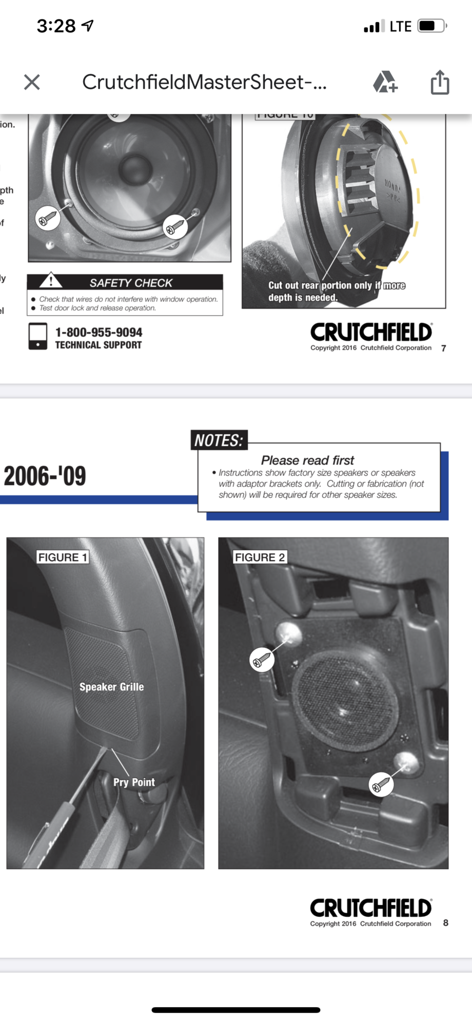

Has anyone upgraded the speakers on the rear pillars behind the headrest on newer ap2s?
What are some suitable upgrade speakers that fit in the pillar? I’m in the process up improving all the speakers in my car as the stock ones seem very dull.

Yeah so I just ordered some new door speakers from crutchfield. The install instructions showed a small part regarding the rear speakers. Thought if these could be upgraded it would make top down driving much better.
