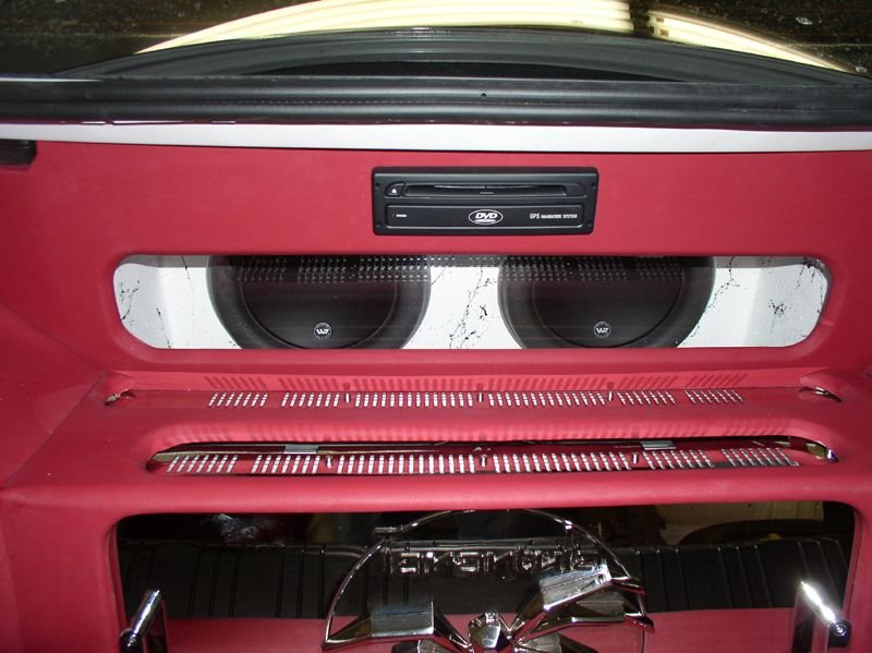

According to PG, the bridged side can go down to 2ohm bridge(according to their instructions), and the load placed on that was wired to 1.0ohm.. So in theory i was giving it too much power.. Correct?
no... the amp is only rated to 2 ohms bridged, and you were running 1 ohm bridged? i'm surprised it wasn't shutting down on you. you should have wired them in series. the Xenon amps are like that... as long as you're in their impedance range, they output the same wattage. i honestly do not know how it will function out of the rated impedance. it may shut down, or just pull back power.
you might want to try wiring it in series and see how it reacts.
if you plan to use that Xenon for the sub only, you could easily bridge 4 channels into 2, then wire each set of channels to 1 coil. (ie, 1 bridged pair per voice coil.). that would give you something on the order of 400 Wrms to the sub.
hope this is making sense.

Yes, it was running in parallel, and iut would dim my lights really bad and sometimes on hot days shutdown.
The installer who did the sintall, did a bad job. Looked nice but all the wiring was hackjob.
I dont want to hook, up the amp entirely to the sub. It powers my front stage aswell.
