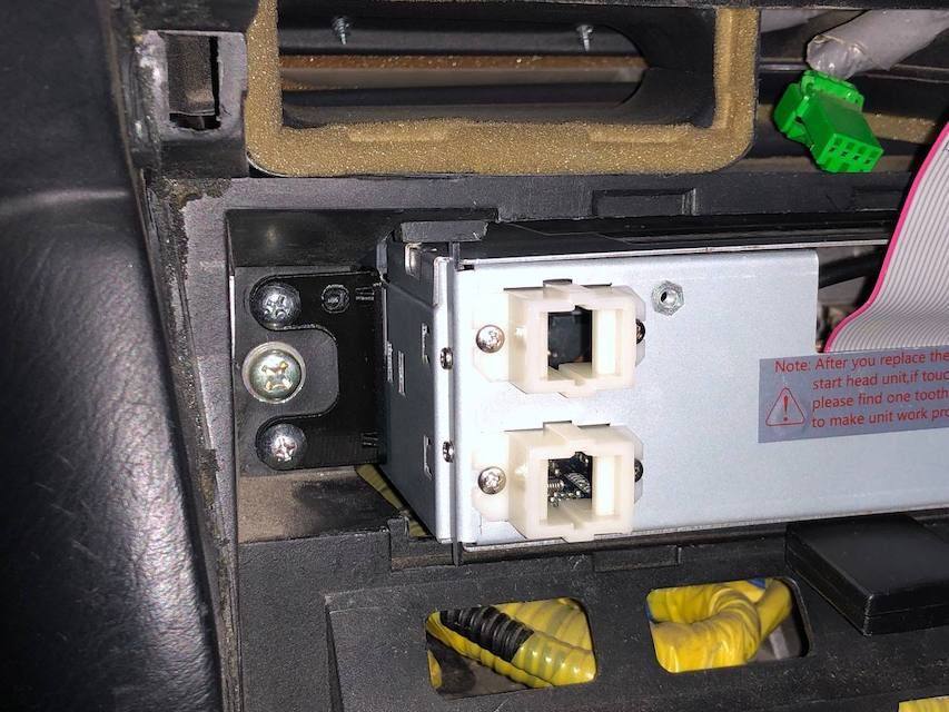

I ended up designing and printing custom ones, but now need to find screws that fit since stock ones are too big:
What are you attaching these to, the mounting sleeve?
No, to the stock mounting location. Just tried it and it's pretty sturdy:
Btw, the stock screws to mount them to the HU don't fit. I ended up picking up M4x12mm, but 8mm or 10mm would be better.

I used the oem radio bracket.

Wow (facepalm)- it never even occurred to me that there were mounting holes on the headunit, I went right for the stupid sleeve.
Would you mind sending me your .stl file? I'd like to print out a set,
