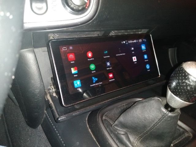

I've now tried three different mounting options.
Option 1: AgentS2K's 3D printed brackets (thanks again!). I like this the best so far. Brings the radio forward enough to allow for keeping the radio surround and vent bezel (without the door).
Option 2: I took AgentS2K's bracket design and tweaked the length to make the radio sit as far back as possible (this is the same position you get if you use the original metal radio brackets, but the 3D printed ones have the hole locations adjusted for the Joying to allow using both mounting holes - and also you don't have to deal with the little metal bumps on the metal bracket that don't line up with the Joying and cause you to have to sort of bend it into position).
This option has the advantage of offering the most distance from the gearshift, and the screen is recessed so it doesn't protrude from the dash at all. Also offers a little more shade on the screen when the top is down. The disadvantage is that it does not use the radio/vent trim so you can see the bare dash opening (really not that noticeable from the driving position (first picture below), but terrible if you look at it straight on (second picture below)). I may revisit this one if I ever feel like designing a 3D printed trim surround to fill in the dash gap.
Option 3: I designed a 3D printed bracket that slips into the slot on the folded down radio door. Advantage is that it is much easier to use the radio with the screen angled, requires no removal of dash trim, and you can still close the radio door if you park and remove the screen (for whatever that is worth). Disadvantage is that it was pretty close to the gear shift. Didn't interfere with shifting but it did block screen viewing. Also I discovered that the screen became almost unreadable in the sun with the top down.
