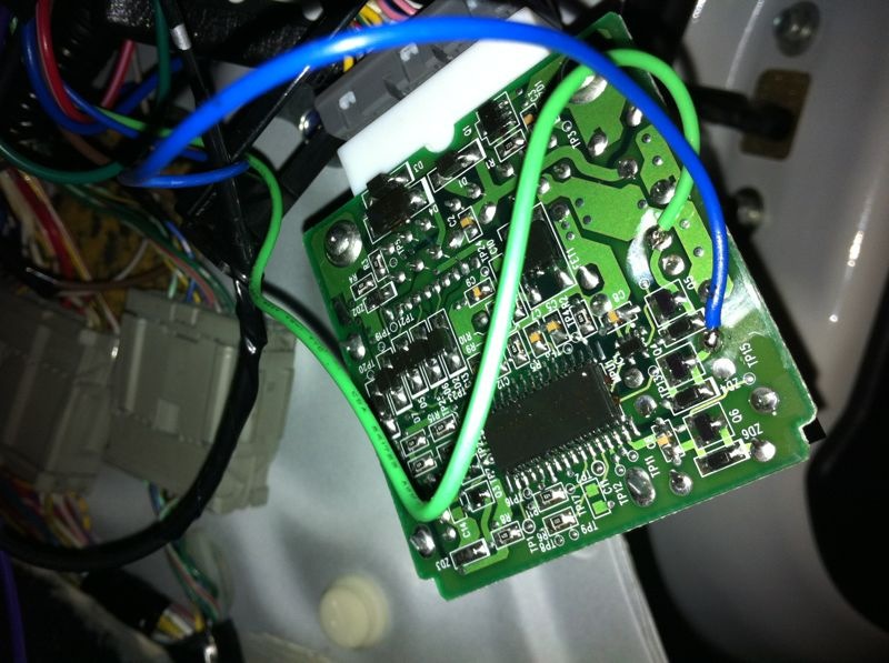

You do not need DEI451M for s2000, just solder the (Door Lock, 3-pin Connector) on the Keyless Module PCB like in the picture.
Here is a Viper Alarm DIY Guide
https://www.s2ki.com/...larm-diy-guide/

Sweet thanks! After scowering the internet for a couple more hours, it appears there are two empty pin slots on the connector to the keyless module. I unplugged the connector and there are two male pins behind them. I read 2 testimonies where it worked. I might do that instead of taking the module apart.

Ah neat! I didnt know you could tap directly to the circuit board. I am glad I could help and you were able to figure it out, and sorry I coulnt give more details. Next time I do an alarm install i'll take a pic while i am in there.
