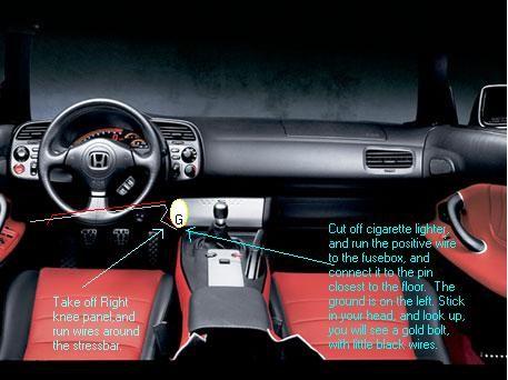

What kind of wires are we hiding here????
Power, Ground and what else? I assume you are plugging it to the cig lighter right?????

Right now I have a splitter run into the cig lighter which I hide under the passenger side seat but the two cables come up to the radar detector and Street Pilot.
The radar should be easy to hide since I can remove the panel that the visor is attached to and run it down to the fuse box.
The GPS is more challenging because of the speaker wires.
I have not opened either one of the units so i assume you obviously have your power, ground, but I don't know how the speaker connections work.

Yea, just follow my directions. Run all the wires under the dash and around the right kneed panel.
