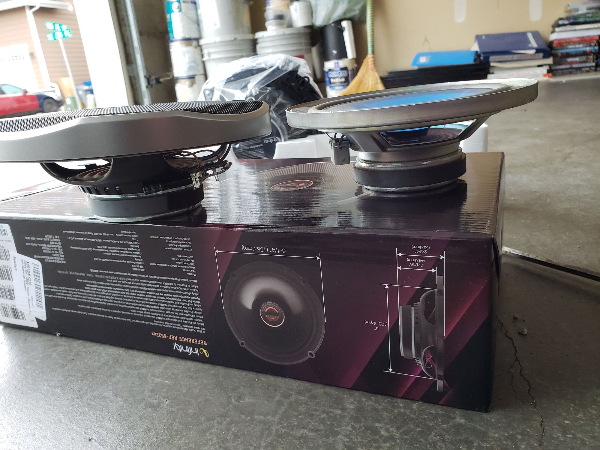

Because of this thread I bought the Alpine UTE-62BTE HU, Modifry PnP harness, Modifry DCI and Metra 72-7800 speaker connectors. I did the install today along with applying dynamat to the front doors and door panels. The speakers I went with are the Infinity Reference 6522EX for like $50. I am very satisfied. Huge improvement over stock. I also have the Alpine KTP445 mini amp on the way too!
