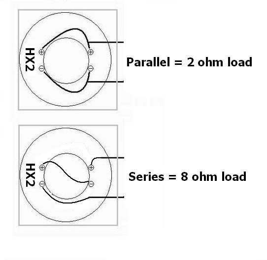

Here are some pics - may help understand speaker wiring (parallel, series, SVC, DVC).

Why do you need ohms and what do they actually do. I know there resistance but why would you want more on a sub. It seems like resistance would make it harder to move the sub.

You will want more resistance if your amp calls for it. Some amps are not stable at lower impediances, and require 4-ohms to operate. Also, the lower the ohm, the hotter the amp will get (as its working harder). Some people like to run their amps cool for efficiency reasons.
