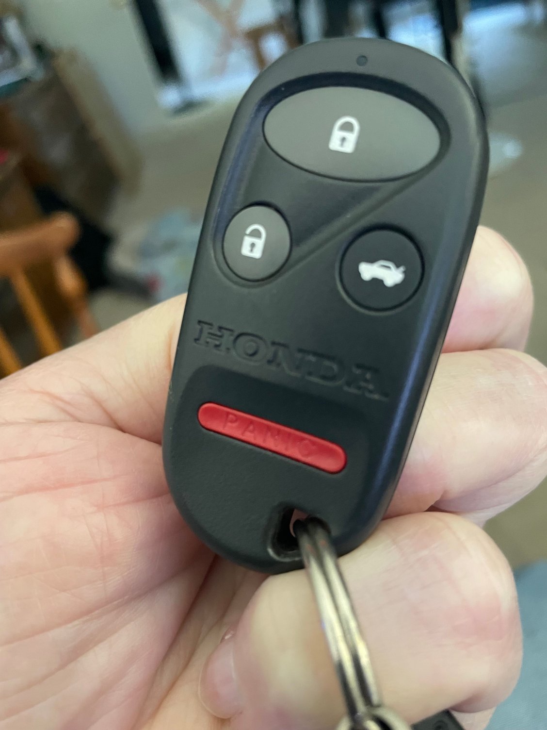

ALL S2000s came with keyless/remote entry with three (3) keys and two (2) remotes. 2 keys that do everything and 1 "valet" key of limited function (as is any of us would let a valet drive or park our car!).
There are different frequencies for the remotes depending on the market and maybe model year which may require dealer or locksmith assistance to program. I think once you get one working remote you can program another yourself.
-- Chuck
Added:
This is the marking on the back of my remotes. It may match the partially obscured data in your photo.

What's the code on the remote you're attempting to link? I think this is critical.
Your receiver shows E4EG8DK (Delta Kilo). You'll notice my 2006 remote is:E4EG8DJ (Delta Juliet) and I'd not expect to work on your car.
I'm wild guessing you need an India or perhaps a Hotel suffix key. Letters I and O are sometimes skipped on part numbers like this as too easily confused with numeral 1 (one) or 0 (zero). Anyway, what's the remote code you're holding? Photo of that label will help.
-- Chuck
