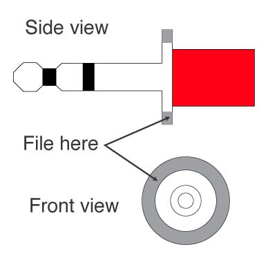

Re the scratchy sound, I haven't honestly tested it again, as I don't listen at very low volumes. But I will check it out and let you know. A funny thing did happen though...I was listening to the CD changer, and then left the car. When I got back in the car and turned the ignition on again, the head unit switched to (started up in) AM Radio...which is weird 'cause I never listen to AM radio!! I seem to recall at that time, the temperature was cold in the car and outside (~35 deg F).
It was ok today, but the fact that this happens randomly is what puzzles me.
I would suggest that all these problems are quite probably the result of the jack plug not being inserted properly. In fact, without wanting to alarm you, I wouldn't suggest you power up with the jack plug not correctly inserted. And if you are going to disconnect it you may as well grind it, and reinsert it.
If problems persist, well then we need to get further into it.

Ahh, but have you done anything? Have you tried the plug grind?
Seriously, it's so easy. Here's a diag for those are are a little confused.
i can't see the picture... can you post the pic on more time?
Nice diagram Aus.
oh, okay.
thank you! i'll go try that right now.

oh, one more question-
what does that extra trim do to the unit?
bad connection? how did you guys find that out?

The extra trim prevents the connector from going all the way into the socket. I discovered it by examining the connetor and the socket. There is a metal or plastic shroud on the Sony that is designed to prevent the connector from fitting.
